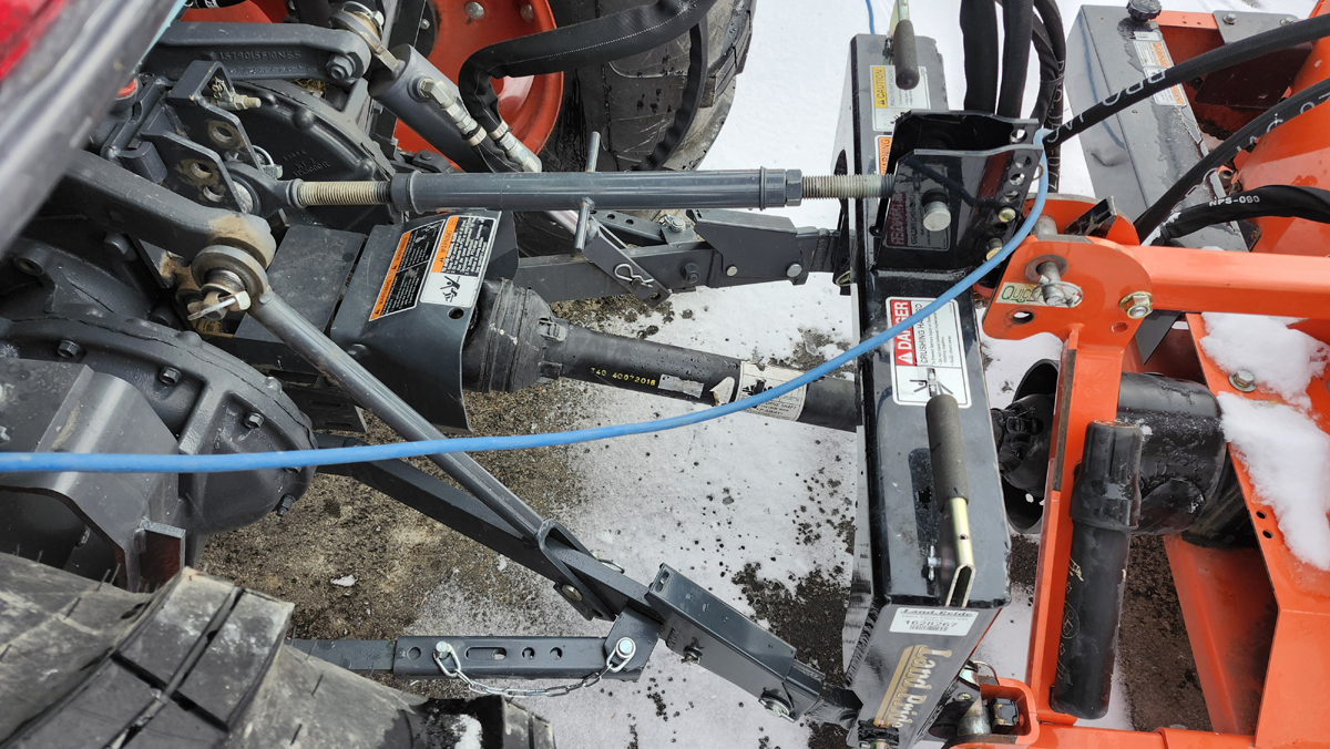

The top link shown below on my MX6000 is 28" from pin to pin with the QH15 attached and a snow blower on the QH15. I typically run a top-n-tilt system on both tractors which has an hydraulic top link, but some implements need two hydraulic circuits so I have to figure out what is more important. For the snow blower I like the hydraulic tilt with float so use a solid top link.

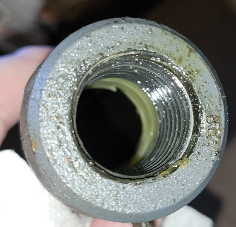

I pulled 2 bent toplinks out of a scrap bin one day. Cut off the ends,welded HD pipe as the center section. Kinda impressed with the amount of RUST inside the original, thin tube.....probably why they bent.
