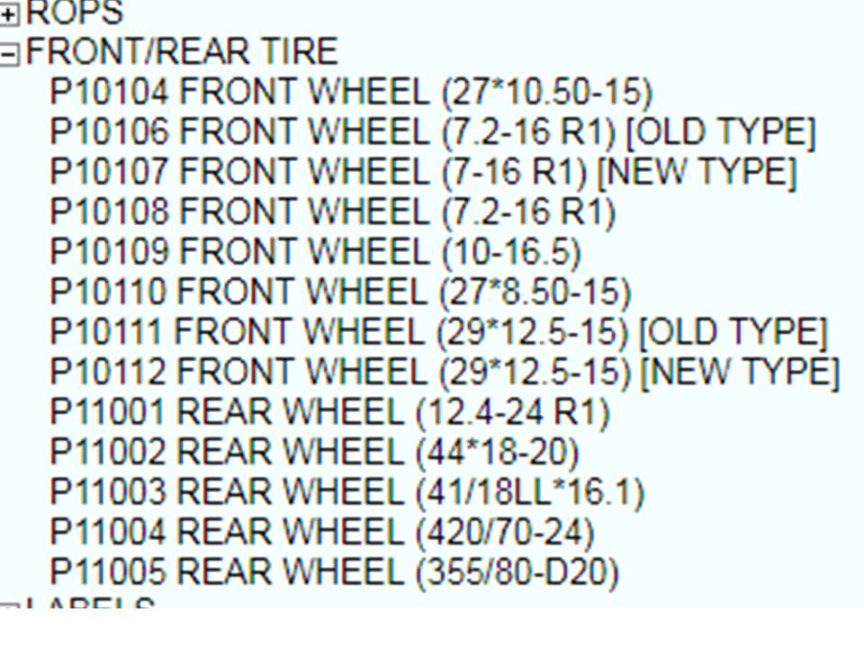

Why is this info not available for Kubotas? I have asked two different dealers and both say Kubota does not supply that info. Am I missing something? Just trying to source different tires/rims for my L3130 HST. Has Industrial lugs on it now. Want to replace with Ag when the time comes. (soon). I have a pdf from firestone that describes the process of using three people and counting tire revolutions (engaged and disengaged) and the subsequent math to obtain the lead/lag. Is that the only / accurate method? Thanks for any help.

Fronts are 7.2-16 RC 89
Rears are 12.4-24 RC136
Your going to have an extremely difficult time varying from these sizes and still getting it to stay in ratio, as it is an odd tire size matchup. ;)

I'm finding, a lot of gear ratios in the final out, but for tires sizes use this
Front old tires were 7.2-16 and new are 7-16
Rear 12.4-24
Front circumference = 87 inches
Rear circumference = 138.7 inches
Not the circumference of the tires. If you divide 138.7/87 = 1.59
So if you find other tires note the circumference and do the calculation. Keep it close if not exact this figure. This way there will be no undo stress on the drive line

BINGO! and that is why I was asking for the mechanical ratio. There are several online calculators that allow for "plugging in" your ratio, and then front/ rear tire combos, with the result being your lead/lag. (but, you have to supply the loaded RC for any specific tire) I'm still waiting to run the test from the PDF I posted earlier. I will post the results here. Thanks for the help.

I guess i'm not understanding why you don't get the right size tires and be done with it?
Because I'm not sure the tires on my tractor are correct. (420/70-24 rear and 10-16.5 front) Handles like a pig on ice in snow! So, I'm gonna run the test and establish my baseline.

Milo,
I can tell you those are the right size and ratio tires for the l3130.
The tire sizes are published for that model.
R4's do not handle snow worth a hoot, you would be much better off with chains or R3's. ;)
