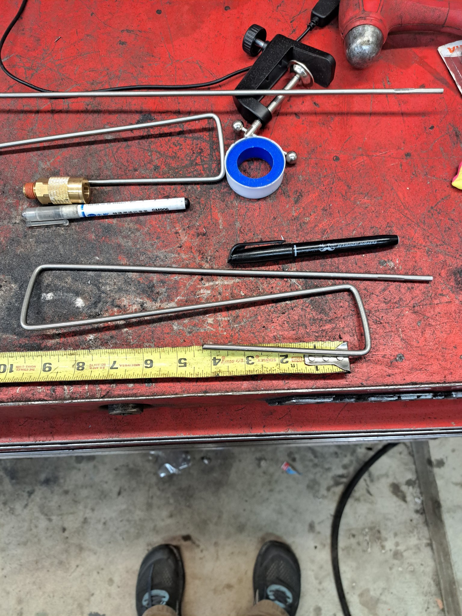

I take some measurements off a previous attempt, but I say to myself that I want to make it "look better" than my first attempt.
I dislike the "Mickey Mouse" looking bends, for the part that grabs the shelf on my first iteration.
(Also note that I cleaned my tool box a little) ;)
For those that would like to make them, here are my measurements for the bends. The last bend is subject to your shelf thickness so it's a little subjective.

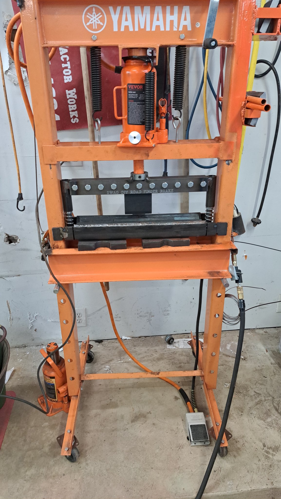

"For the first time anywhere....Meet my new "air over" press!!!!!!! YAAAAAYYYYYY!!!!!

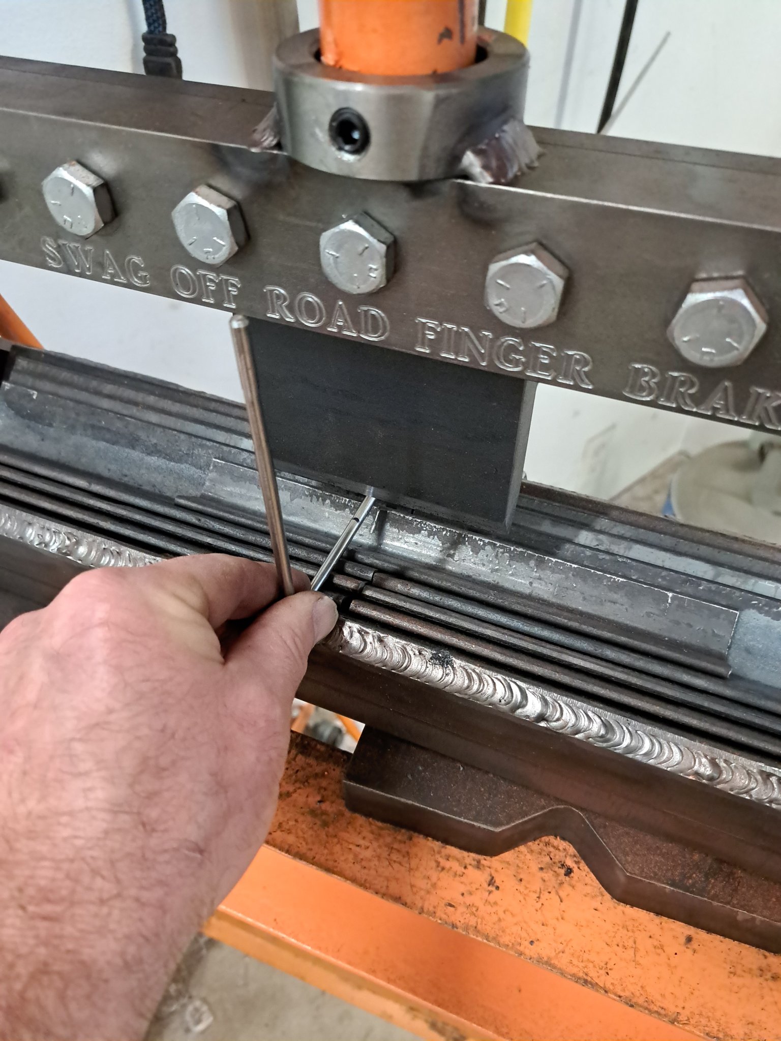

First bend goes great....exactly as planned.
But there is "trouble brewing in Denmark" for the second bend.
Damn it.......the short piece is gonna hit the press......

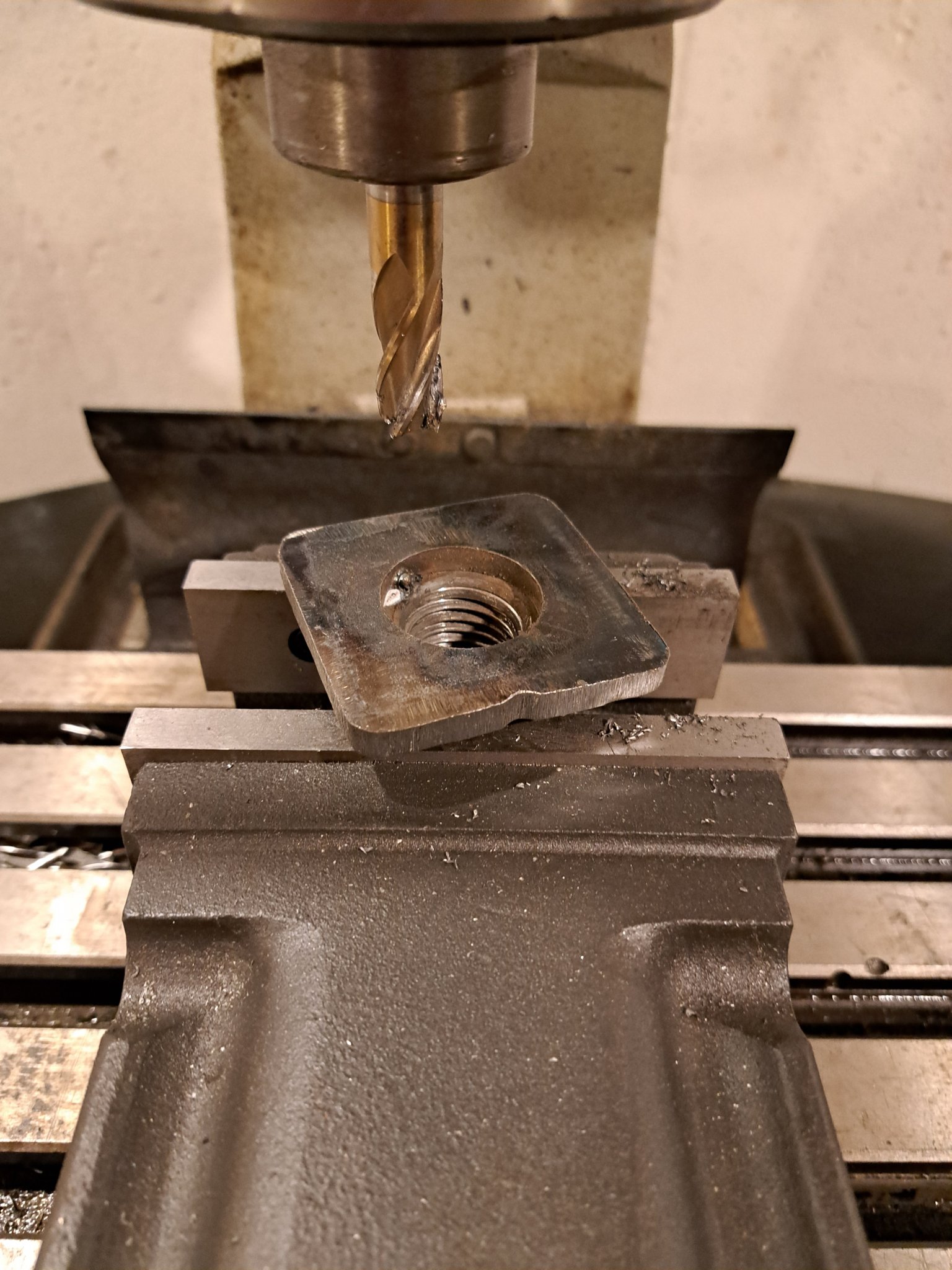

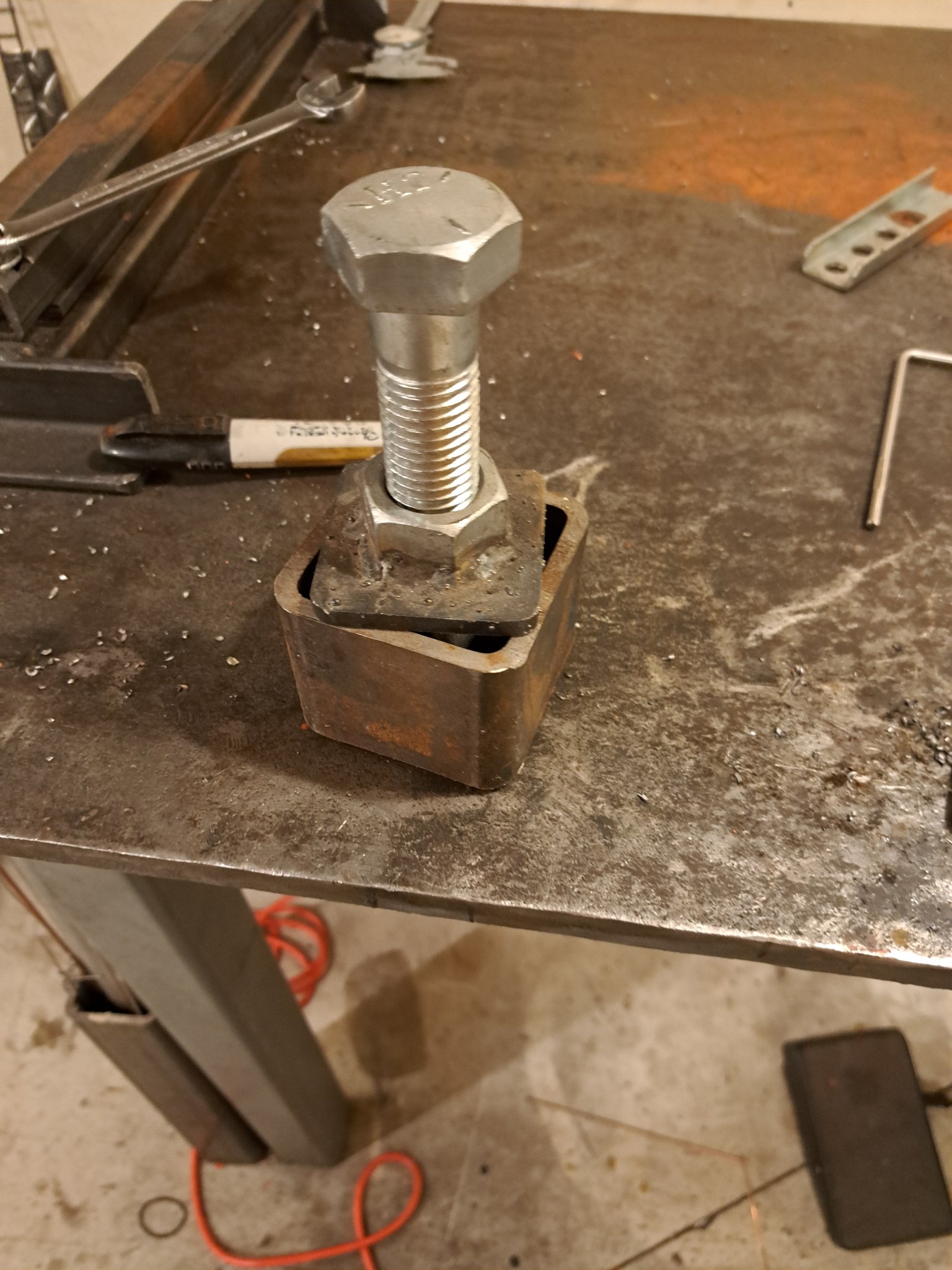

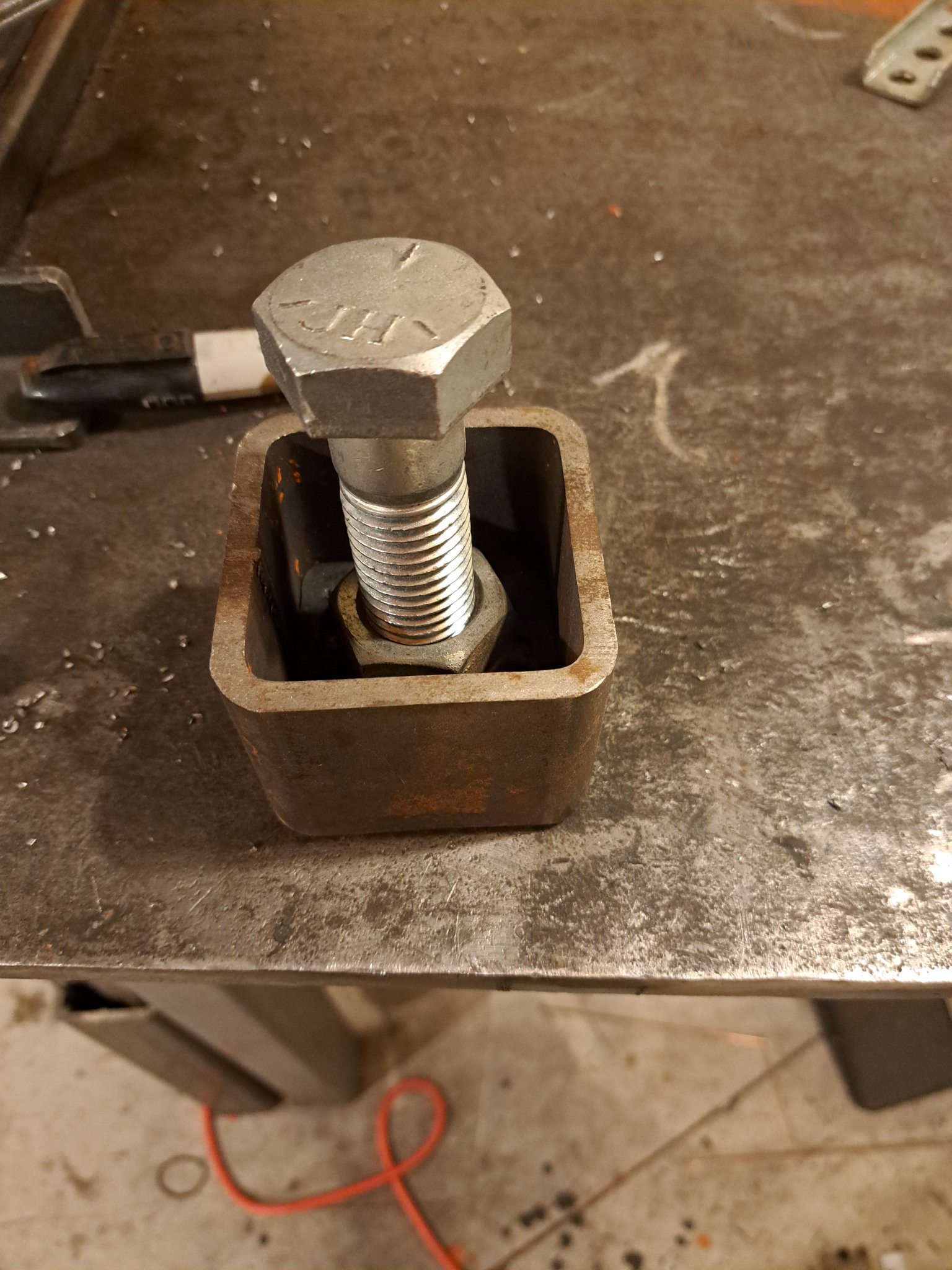

I am thinking that if I can make the leveling foot "fit into" a piece of square tubing, I could make 2 bends at one time and avoid all that "cardio BS".
A little work with the grinder and there she sits.
Now it's off to the mill to "notch" it out, to allow for the tig rod when I press it down.
but as you can see the nut is welded on "cock-eyed" (mostly because it was never designed for this)
So in order to be able to make 2 "notches" that line up perfectly by using the "x" (?) axis of the table, I need to get a little creative to hold the vice in place.
Now do the other side.
Fits "like a glove"

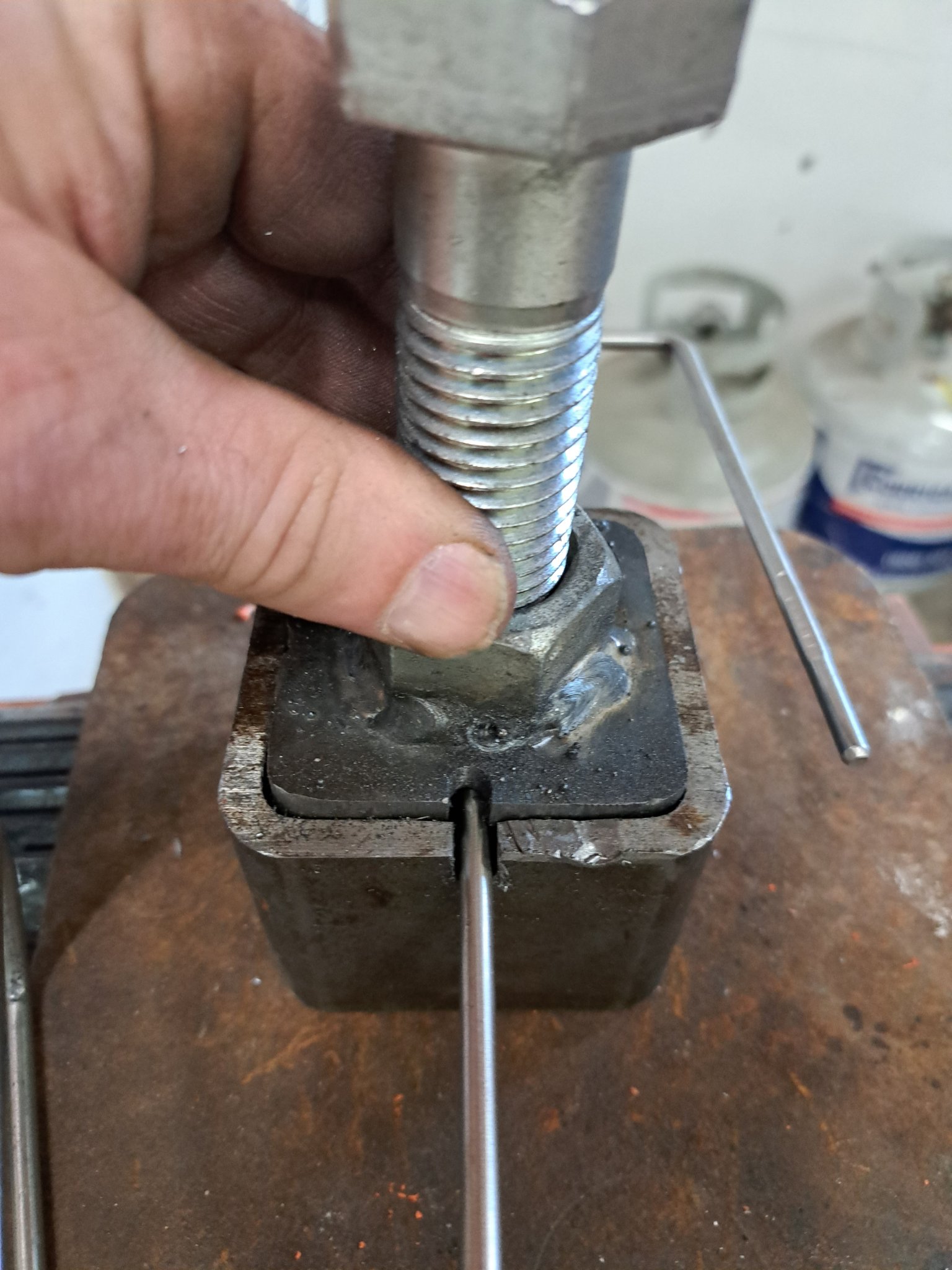

Lining it up for the first bend is problematic.
It wants to "jump around" a little, so the first test press gets "away from me a little" and gets "slightly stuck"

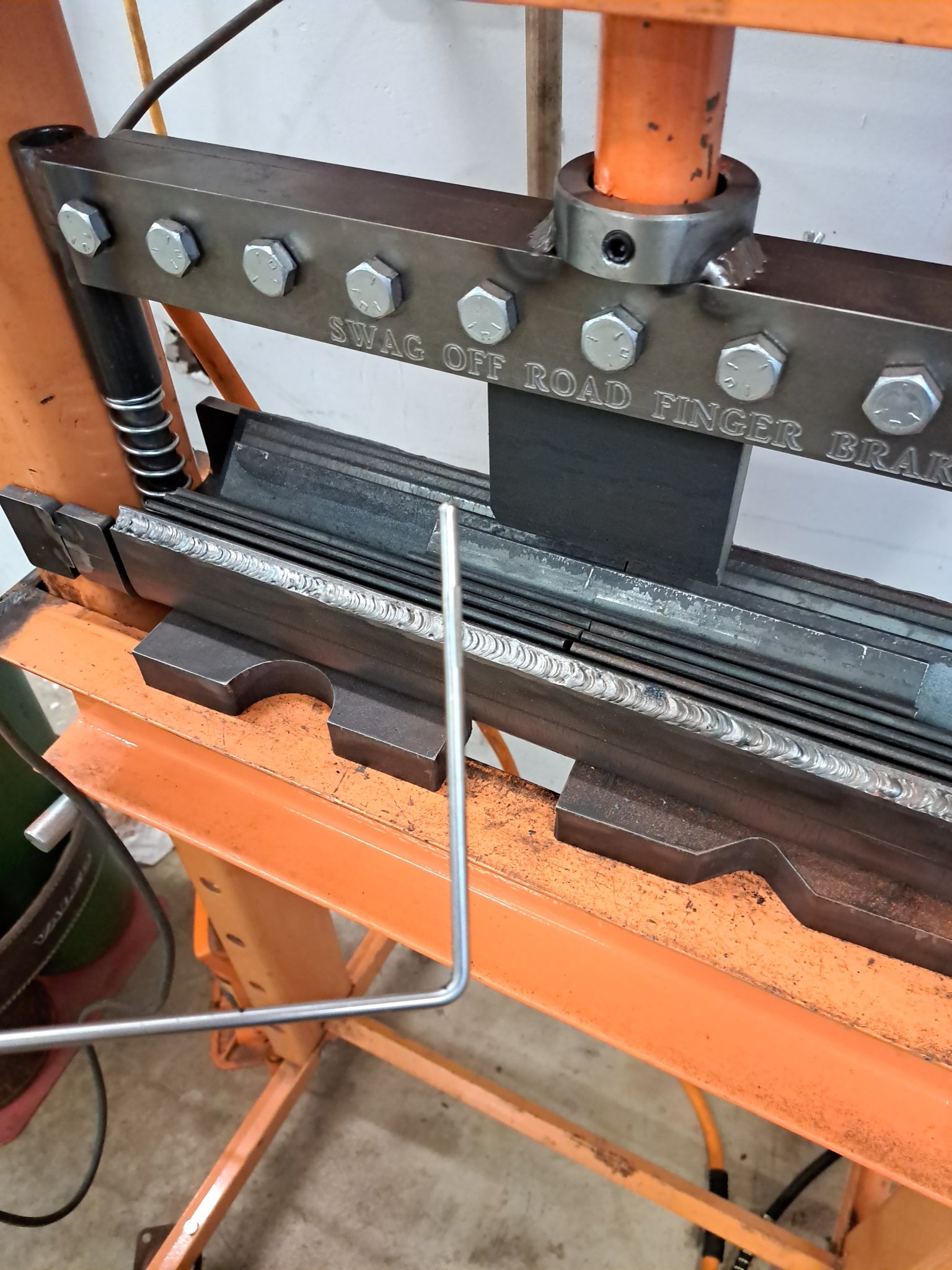

With a little "finaggling" I get what I call "acceptable first results", but I do see that the top of the piece is hitting the press, putting an unwanted "kink" in the piece.
But I am digging the nice 90 degree bends for sure! (y)

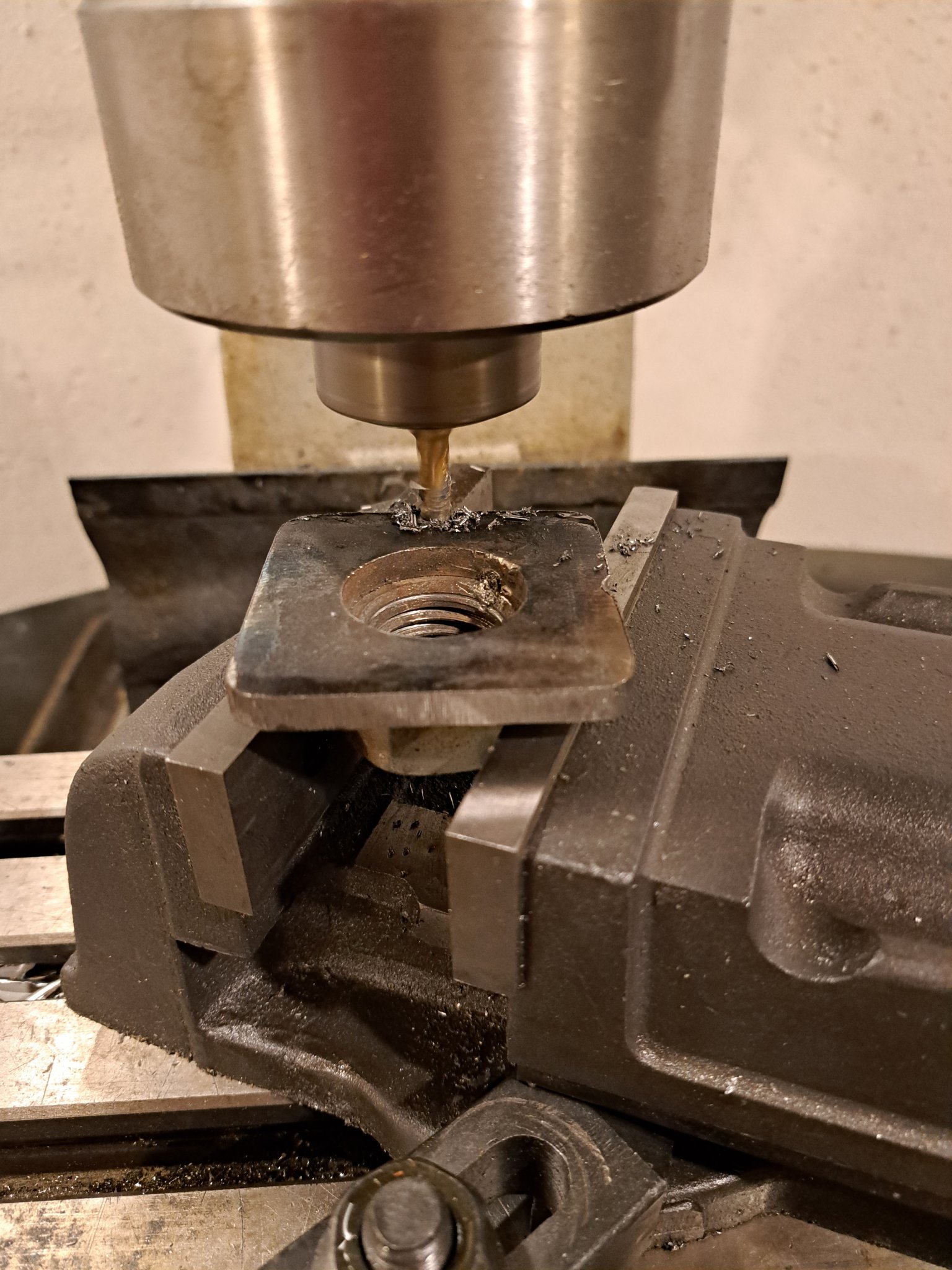

I reason that some a "longer distance" between the press and the piece should take care of that "kinking" problem and that slightly deeper "holding cuts" will/should help with initial alignment of the piece to prevent gettting a "cock-eyed" start.
So it's back to the mill.
I carefully line it up, and start to mill a deeper cut......
Then BAM......WTF?????? The piece jumps out and "_acks up" the top a little
After a "light tirade of cursing", I find out that bottom of the piece had a series of "booger welds" that are not letting it clamp properly, so out with the grinder.
Now she sits a little deeper so the "male piece" fits in about 1/8 inch to help get it started.

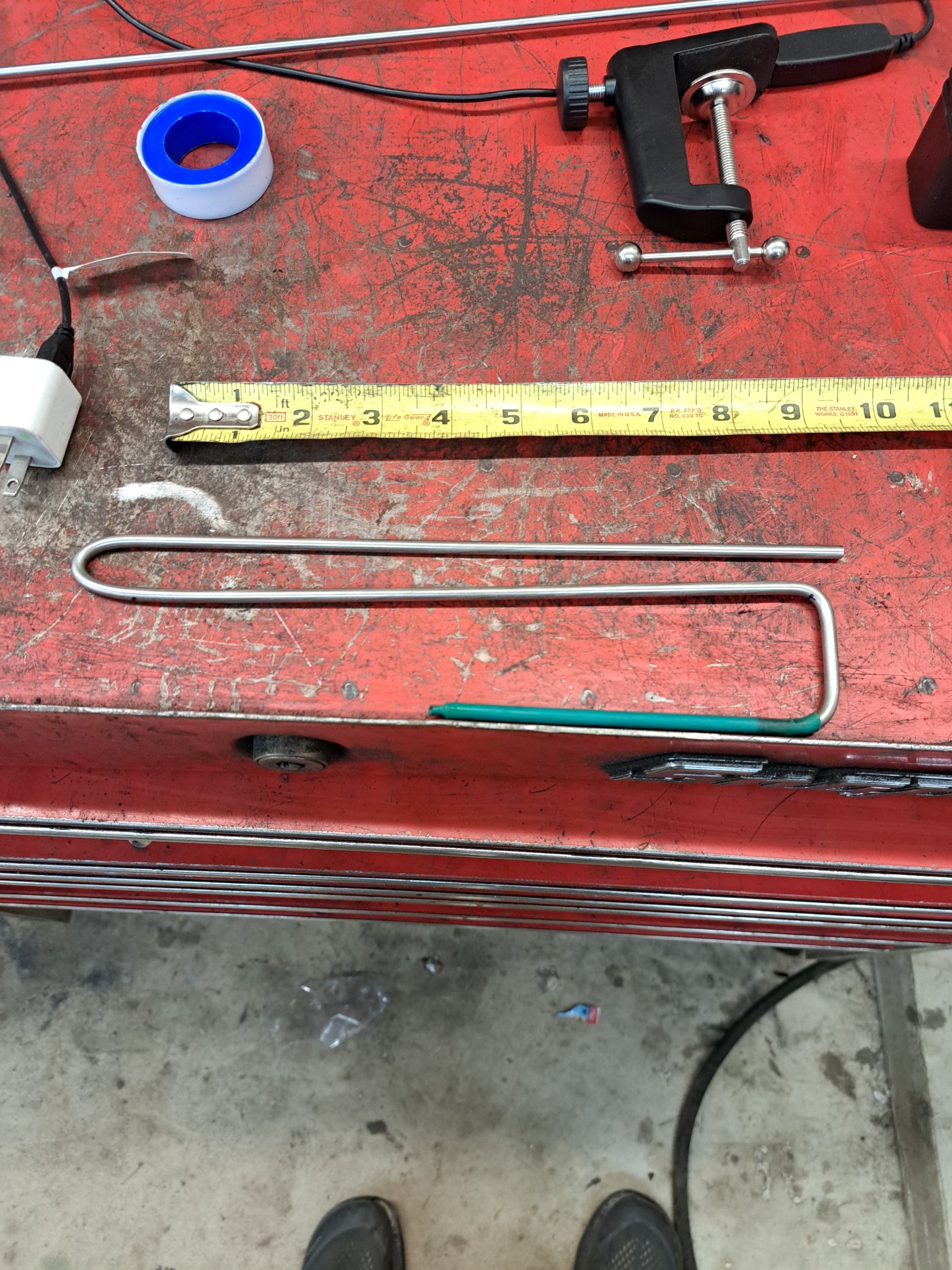

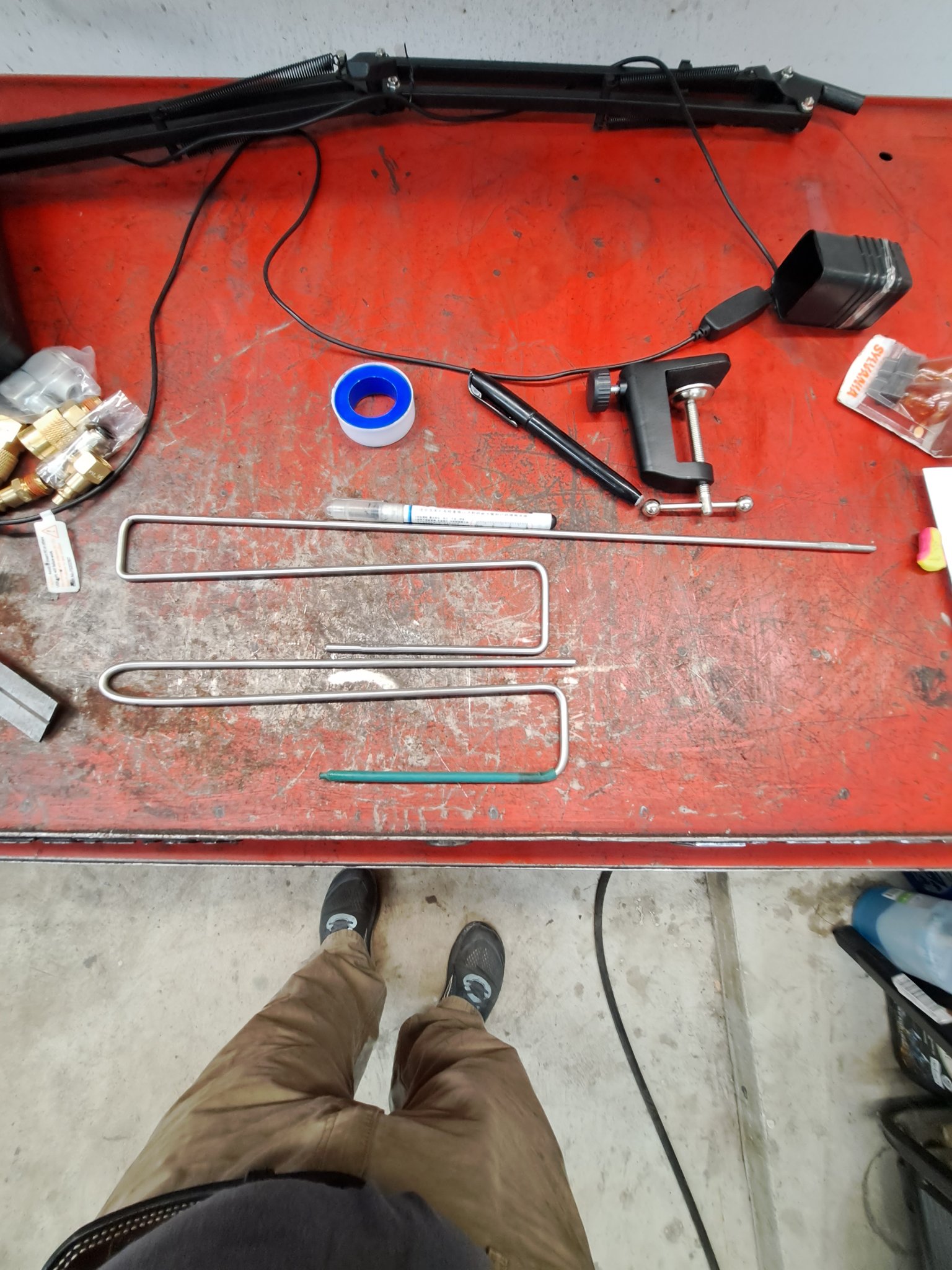

Well here are are boys........I am liking the final results and it works pretty good.
I like the concept, but the bends seem a little too wide, so I have to "squinch them" down with my hand a little to make sure they "grab the shelf" when "my friend" grabs a pistol and pulls it off.
I will see what it looks like "in real life" and decide if I am going to make the "press die" (?) a little narrower.
luckily "my friend" stopped by and he had something to test it with.

These are for hanging off the pre-installed shelf, so no holes for the "peg board hook".
.22's are a little tight, but other than that, no problems with diameter.
I hate the idea of steel inside the bore of a firearm.
Heatshrink is one solution.
I wonder if a brass rod wouldn’t be kinder.
I do something many folks abhor …. I store them in lined-holsters on belts. (but they’re dry and despite decades of such storage…no rust or other damage.
I agree with 'Naked steel" inside the bores but heat-shrink works well.
"My friend" also uses the pockets on the door, but uses Rig_Rag grease for those ones. Never had a problem yet.
