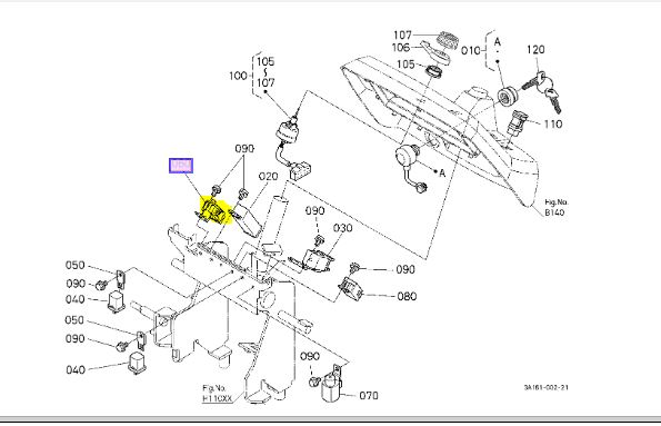

Yes, from the large positive terminal to the spade terminal is how I had it. And the only relays I could find were in the very front of the tractor on the left. One was 65 amp and the other three were 30 amp, is one of those the starter relay?
The starter relay is under the dash panel:
