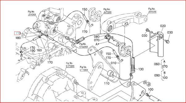

On your model you have 2 remote cylinders that lift the three point.
It's real easy on the model to find out if you have a bad lift cylinder.
Remove the small clamped hose (#150) on the top of each lift cylinder lift the three point and if fluid comes out either top port and the lift falls then it's got a bad cylinder.
If they fall but no fluid comes out, you have a valve issue.

This is frustrating. I was moving some hay yesterday. Put a spear on the back. Went to pick up a roll and I couldn't set it down. 3pt wouldn't do anything. Not up or down. Had to wrap a chain around the roll a drag it off the spear. 3 pt started working fine.
I tried it again on another roll just to make sure. Wouldn't do anything with weight on it. I cut the tractor off. And after a few minutes it just seemed to release and the 3pt fell, because I had it on the lowest setting. WSM says this is the control valve.
Ill check the lift cylinders like Wolfman said here in a little while.
ETA: Pulled off the clamped hoses. No fluid. Definitely is the control valve. Thanks for all the help and input. I'm probably gonna carry it to the Kubota place. I see this as something i could make worse by opening it up and messing with it.
