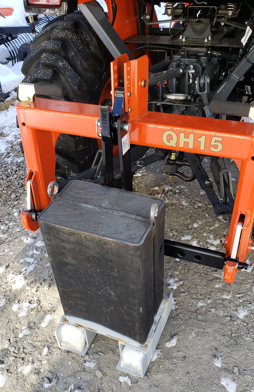

I hang 800lb off the back of mine. I wanted it as dense as possible so I filled a steel box with lead (I couldn't afford gold). I can pick it in either direction so I can get it super close or let it hang.
eipo
L4060
Dec 1, 2015
693
81
MI
I estimate the one I made is right around 1000 pounds.
