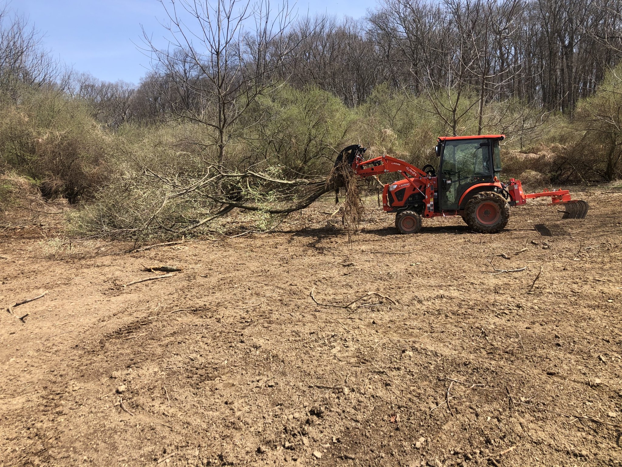

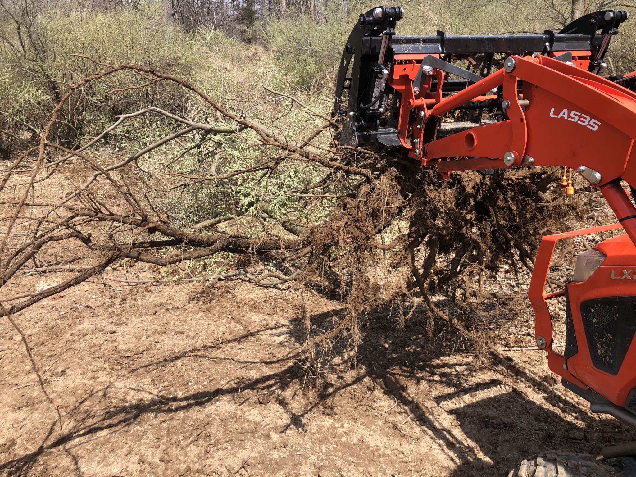

I have a 2610 with a cab, spacers, etc. It handles everything I throw at it. I have a 60” brush hog and I’ve mowed some tall grass with it. I just have to control the speed.
As long as you aren’t trying to mow 5’ high grass, you should be fine.
The cab is great. Every time I use my tractor, I’m glad I got the cab. It makes everything much more enjoyable.
I am also clearing land with it. Ripping out barberry and Russian olives. I have an Everything Attachements wickeder grapple. It’s worth the wait.
I'll have to look into that grapple. Thank you for your feedback. Your guys are selling going cab is the way to go.
