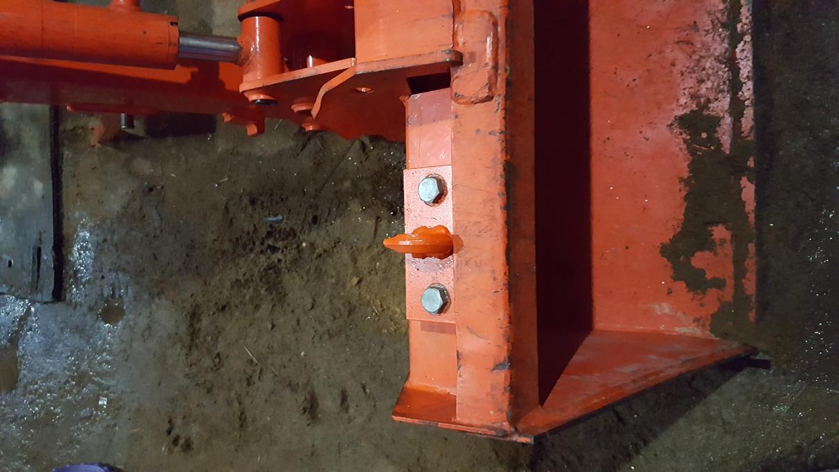

Ken's hooks are great. Easy to install and a good clean, factory, look. No worries drilling holes in the bucket. I have a hook bolted to the top side of the center of my bucket an a clevis point bolted on the top side of the inside of my bucket. I use the clevis point the most.
Great combo idea, thanks!

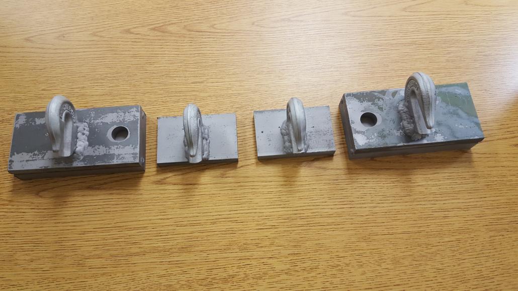

Guys,
I am gonna chime in here - as a welder (not a great one however) the WELD to the bucket is fine - but remember, the footprint of a weld on both sides of a hook are placing a hellva lot of pressure on the THAT spot on the bucket!!!
SO - if someone was to jerk the hell out of the bucket hook - all of that force will be applied to a small area OF THE BUCKET, sure the weld should hold, but the bucket could deform.
When a hook is welded to a plate - the plate is is inherently thicker than the bucket material - thus the pressure when BOLTED to the bucket places a stress on a larger surface area. Now the pressure is placed on the bolts!
I would make sure that the grade of bolts far exceeds the weld breaking strength. The washer used on the head side and nut side of the bucket will also decrease the pressure at that specific point.
Weld on hooks are fine - guessing over the last 50 years more than 80% of all hooks are welded on and 99.99% of those are probably fine. I wanted to weld on a plate and have that plate rise up a bit higher than the bucket edge- When I roll the bucket - the chain bangs up the upper lip of the bucket.....and being a finicky a$$ - I could not stand it!!!!!:D
This is 2 .500 inch plates with the hook - ground and welded. Cannot remember what rod I used. - and dont look at that bubble gum to hard!:eek:

Good point, when I asked my dealer about welding the hooks, they said they wouldn't do it to the older style buckets, but the new ones are sufficiently reinforced to take the lifting strain. On the older ones, they weld a support plate in place across the top of the bucket before welding the hooks on.
