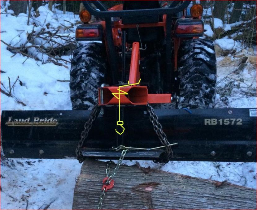

I'm in the process of pulling big cedar trees out of the woods. I was using the rear blade with a chain wrapped around it & the log. This was working ok, but wasn't the surest way of knowing if have lift on the but end of the log. As if start moving out the log would normally end up dragging at the blade. This would be ok, but, the area I'm in isn't too favorable for the log dragging due to the fact it tears out the frosted part of the trail resulting in huge ruts. The ground is actually made up of crystallized frost, which although does allow me to get to where I need to go, isn't even close to putting up a fuss for the logs.
So, i called my Kubota dealer,.... They sold me a bar to tie in the lift arms with, as well as a hook to fasten to bar. And then a choker chain to go around the log. This sounds great in theory, but gives little to no lift to get the log up.
I understand the importance of being safe and the risk of flipping the tractor. Thus, I lift it only enough to get it off the ground to pull.
Here's what I'm looking at going to -
I don't want to possibly damage the blade, so wrapping the main chain around blade & arm, etc.
As seen here in this picture minus the choker chain-
Next, putting the same size heavier chain attached to each side of the existing chain as shown by the tape measure-
Lastly, installing "Hook" to cross chain as shown-
Then, I'd use the choker chain to fasten to the hook. What do you guys think? Would lap links hold well enough to fasten the cross chain ends as well as the "hook"?

While I normally would suggest what you doing is not good, I have to do some of the same with my logs.
It actual works very well for lift and extra safety and stability having the blade instead of just a hook.

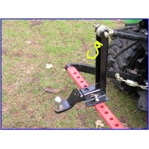

Another option is to add a center link option to the bar and get the hook up higher.
Here is what I would do:
If you want to cut down on noise and paint scrapes use a strap but a chain will work.
Tie the chain or strap around the front and drape the end and hook over the back center, use a short chain or loop the strap through the rear center section to keep the chain from walking side to side.
You could even put a piece of hose over the chain where it goes over the back to keep the wear down.
If you can weld, Weld a plate with and eye onto the back of the blades frame, I have a receiver attached to the back of my blade so I can move trailers around when I use the blade for things like snow clearing, also works handy for towing a small log trailer out the loading it and towing it back.

No, no, no, no, no... Don't do that! It magnifies the weight of the log many times over and the effective pulling point becomes something just above the top link attachment on the tractor. It is a guaranteed way to have the front end of the tractor in the air which on uneven terrain (normal in a wooded area) will result in severe instability.
Draft inducing implements or loads must never be hitched above the level of the drawbar or the level of the mounting pins for the lower three point links (which are usually at about the same level +/- a couple inches). Nothing good comes of that arrangement!
I'm not a safety freak, but I've had the front of a tractor off the ground enough times to know it should be avoided unless of course you're hitched to the front of a sled on a level pulling track.

I hang my tongs from the top of the rear blade frame, about like Wolfman's 2nd photo. The blade is turned backwards. I can adjust height, if needed, by using the top link.

Ahhhh, I think I've finally got it! It works like a charm. However Wolfman, as you said it does seem to scratch & ding a bit more than I originally thought it would. I'm going to look into a tire or something of that sort to keep it protected. All in all, at least making progress. Thanks guys!

I understand never say never,.... But, the trail is an ice rink. If the log were to try to stop the tractor by snagging up on something, the tires would brake free and spin.
