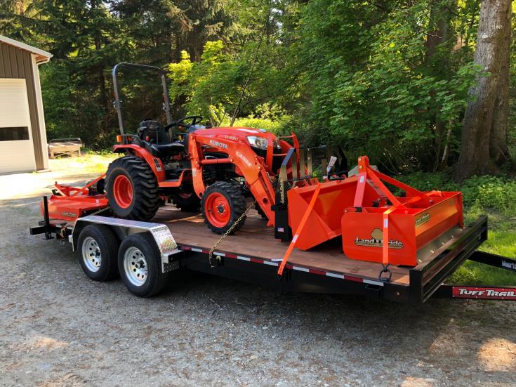

I'd put the tiller in the bed on a sheet of plywood. Then put the box blade, back end forward, on the nose of the trailer. Place a 2x6 across the top of the box blade, tip your bucket down, and rest it on the 2x6 with the mower on your 3 point. If you have extra room on the trailer you could put the tiller in front of the box blade and still rest your bucket on the box blade. This would shift your tractor back a couple of feet, maintaining the CG relative to the axles.
Similar to my pic below (B2650 on an 18' trailer) but with the bucket on the box blade (mine wasn't because I had forks as well). This should balance your trailer well and keep your mower up on the trailer.
As previously mentioned, secure the tractor with at least two chains and every implement with at least one strap, including removable implements attached to the tractor.

Id be extremely cautious with using straps like that in the picture above. Not a good idea at all. Those straps can/will wear through in no time laying against the bucket/box blade like that.
True, and a great point. I had one almost wear through on a 20 mile drive home with a new lawn tractor. Now I use plastic strap protectors that go over the edges of the box blade or any other implements to protect the straps from wear. I think I picked them up at Home Depot for a couple dollars each and they work great.
