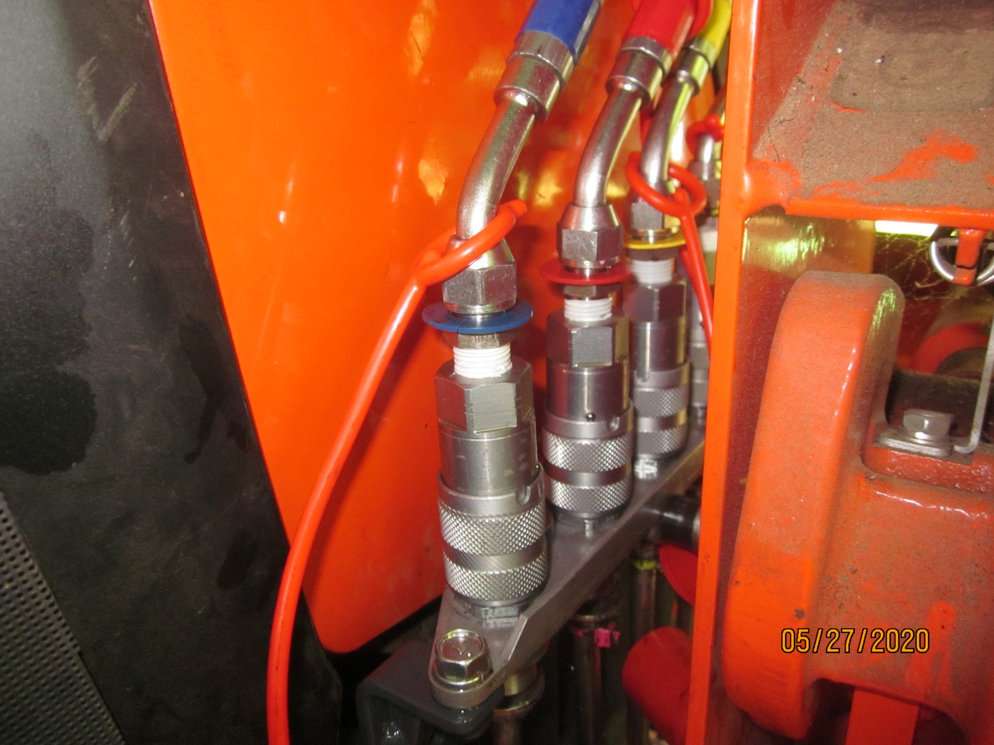

Lots of folks will tell you, "Just make sure it's clean." BS. You could've eaten off mine. Had it replaced once by dealer. Still leaked because it's a shitty design. The locking point is right in the middle which in effect becomes a pivot point allowing both ends of the connector to rock. I did this and no more leaks.

I saw a YouTube video where someone did exactly that. Would you happen to know part numbers for that? I think I need to do that. I’ve not read anything good about the Kubota coupler. It seems like the main point of contention with this tractor.

imnukensc is correct, poor design. I had mine replaced with the “new” coupler and it still leaked. Found that if I rocked the coupler front to back when engaging the lever, the coupler would seat better and would not leak. Issue was that the lever does not allow for the two coupler pieces to be parallel when engaged. Doing it fast, they would be slightly cocked and would leak. Slow and rocking it; no issues.

Isn't that a Multi- Faster system?
MultiFaster are the market reference to connect multiple lines, allowing an effortless connection even with residual pressure in the system.

Does anyone have info on this?
Listed the parts needed in this thread in post #18. I only replaced the upper female couplers and used some adapters.
