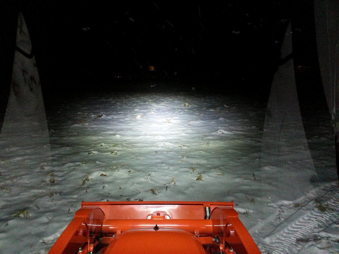

With the light you see from yours do you think one would replace a headlight well?

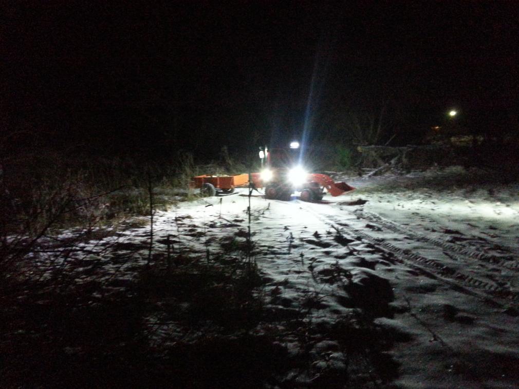

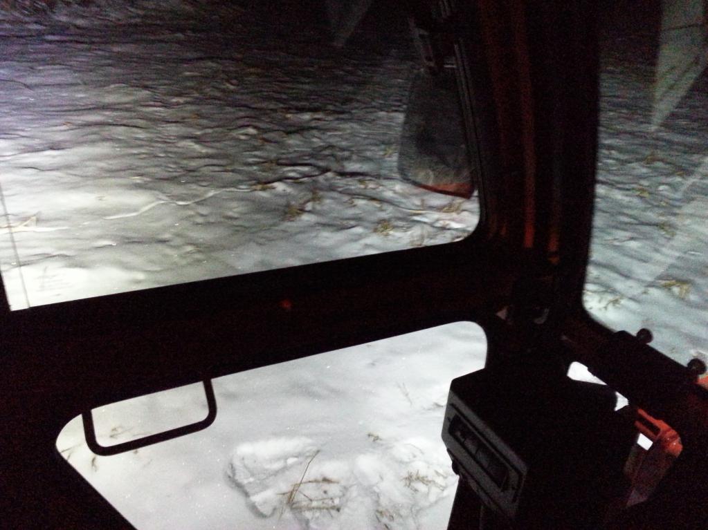

I know LEDs are a strange animal to me, and I cannot find any articles that compare one to the other. But then I may not be asking the right question. So I ask here. How does one compare the light output of say a 55watt halogen spot light to an equivalent LED spot light.
I know they list them in watts, but before I spend boucoup danarois on a LED light bar, I would like to find out how to compare one against the other. I have my lights 2, 55 watt halogen driving lights mounted on the ROPS ( which I cant seem to get downloaded) and would like to replace them with a low profile LED light bar. And I want the same or maybe better light out put for night time use of the tractor, (well duhh why else would i want them huh,,lol) any ideas here guys?
Skeets,
Cree, Leds are the best , but I did not find this out when I purchased my tractor.
I use a 20 LED, 4000 LUM light bar for my front and small 4x4, 8 LED 1450 LUM for my sides and back lights.
I just went with "TUFF" leds , off of Ebay, with no problems after one year of use.
