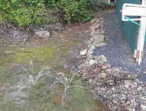

Not sure if you have the room to do it, but my well is next to a storage shed. I measured how far between the spindles for the blades and built a little manifold out of copper tubing with pipe caps at the end that I drilled at a 45 degree angle. basically a sprinkler head with alot more volume.
Buried the whole thing underground and plumbed it into a valve mounted on the side of the shed.
When I'm done mowing, pull next to shed, turn water on and start blades. If it was wet when I mowed, let run longer [like 20 seconds instead of ten] It does knock the real good cutting edge off of the blades but I'm not that picky, they don't have to be razor sharp.
When I buried it , I bedded it in rock and at the lowest point I drilled the smallest hole that I had a drill bit for. It sprays when I have the water on but dissipates into the gravel. When the water is shut off, it self drains so there is no muddy area or puddle to draw the yellow jackets.
Some people I have told this too use sprinkler heads and PVC.
I wanted more volume and a little more durable. Been useing it for about 15 years now.

wait whaaaaa? lol That sounds really cool ......got any pictures or video you can upload? I gotta see this!

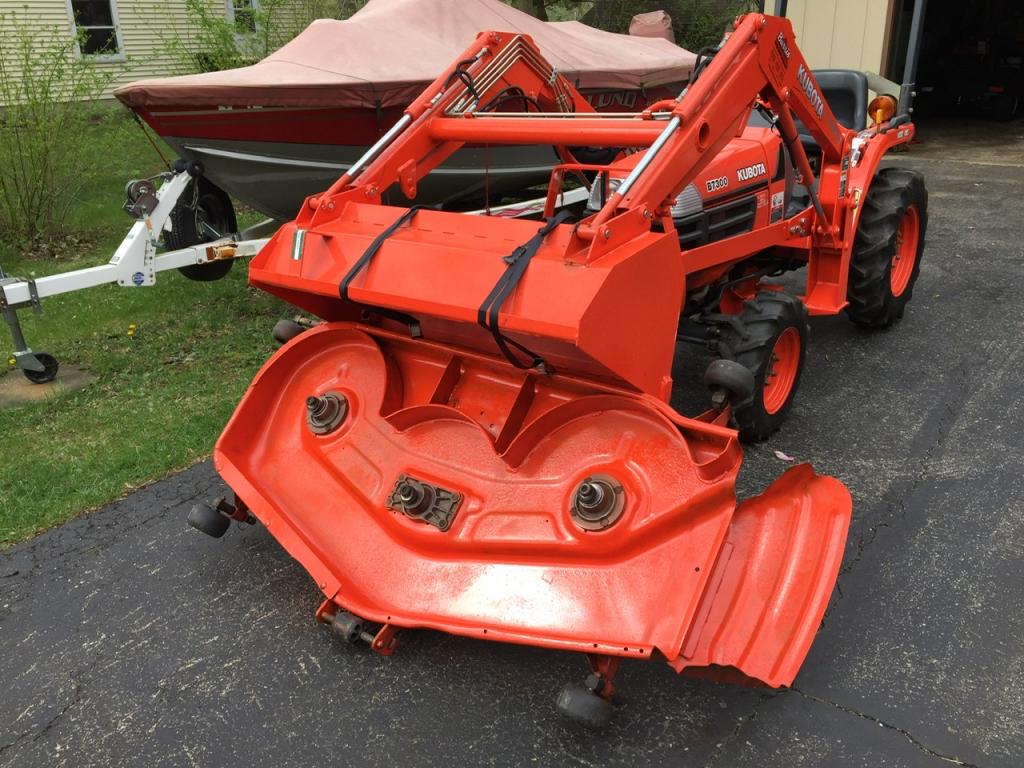

This basically what I did. Where are the straps attached too on both ends? Thanks for the pictures!
I hooked to the frame bumpers on the top of the deck which are good, balanced lifting points. The straps wrap around the bucket, teeth down, to avoid any sharp edges. Otherwise use softeners under the straps at sharp contact points.
