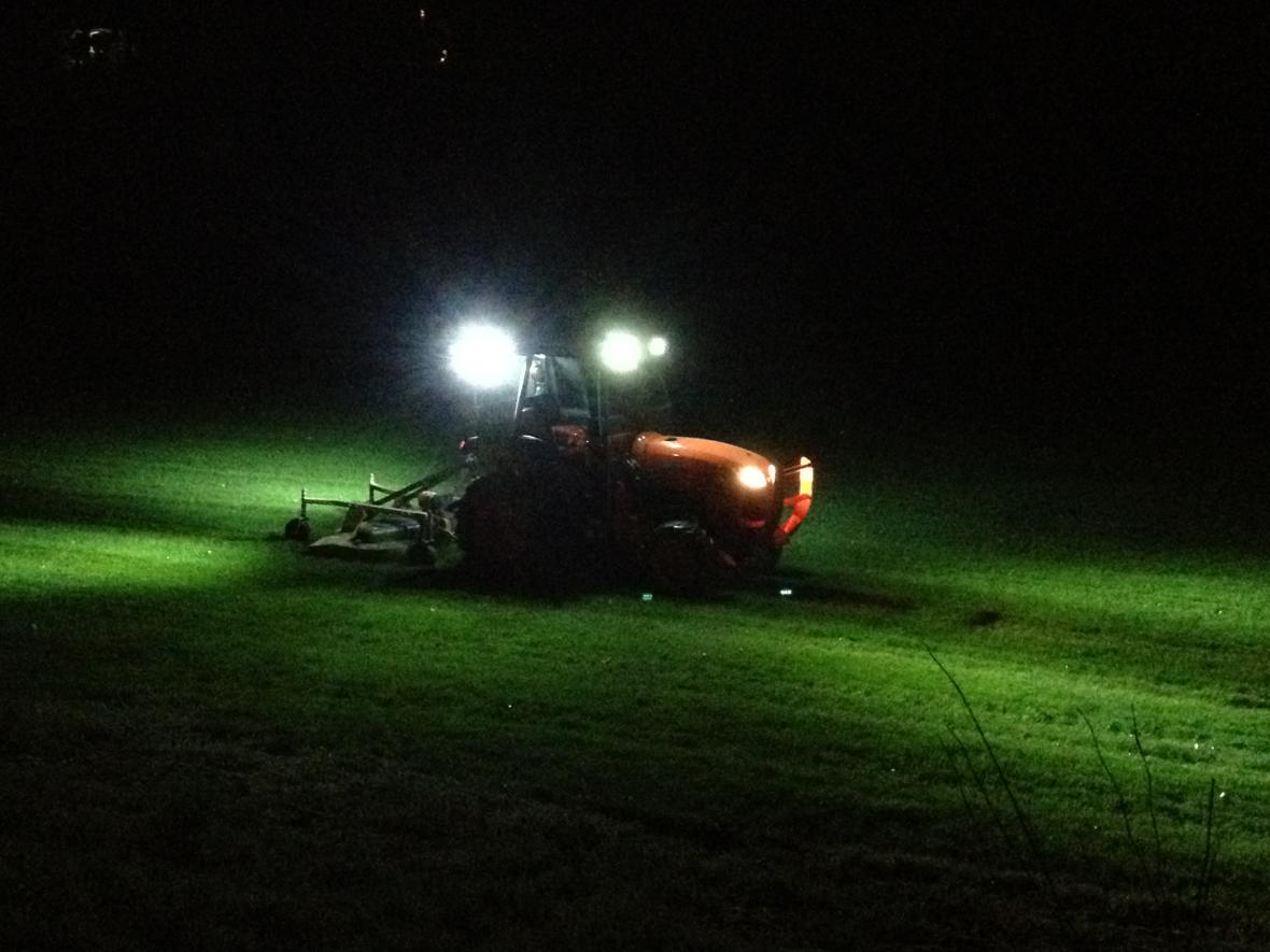

I agree with Paul, you are not going fast enough to heed spots.
I used 4 flood LED flood lights -2 forward and 2 back. They provide me with all the light I want/need. 2 floods give me about 120deg of light in the front and back. The only thing I would do differently if I wanted to see further in the front would be to add one spot in the middle.

A combination would be good, but if you get only one type I'd definitely get the floods. I put 2 led floods on my ROPS for the front and 1 standard light for the back. The fronts light up more than enough distance for my uses. Like Ben S, I got the www.ropslights.com setup. High quality and easy to install.
