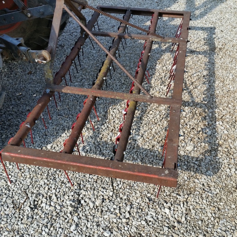

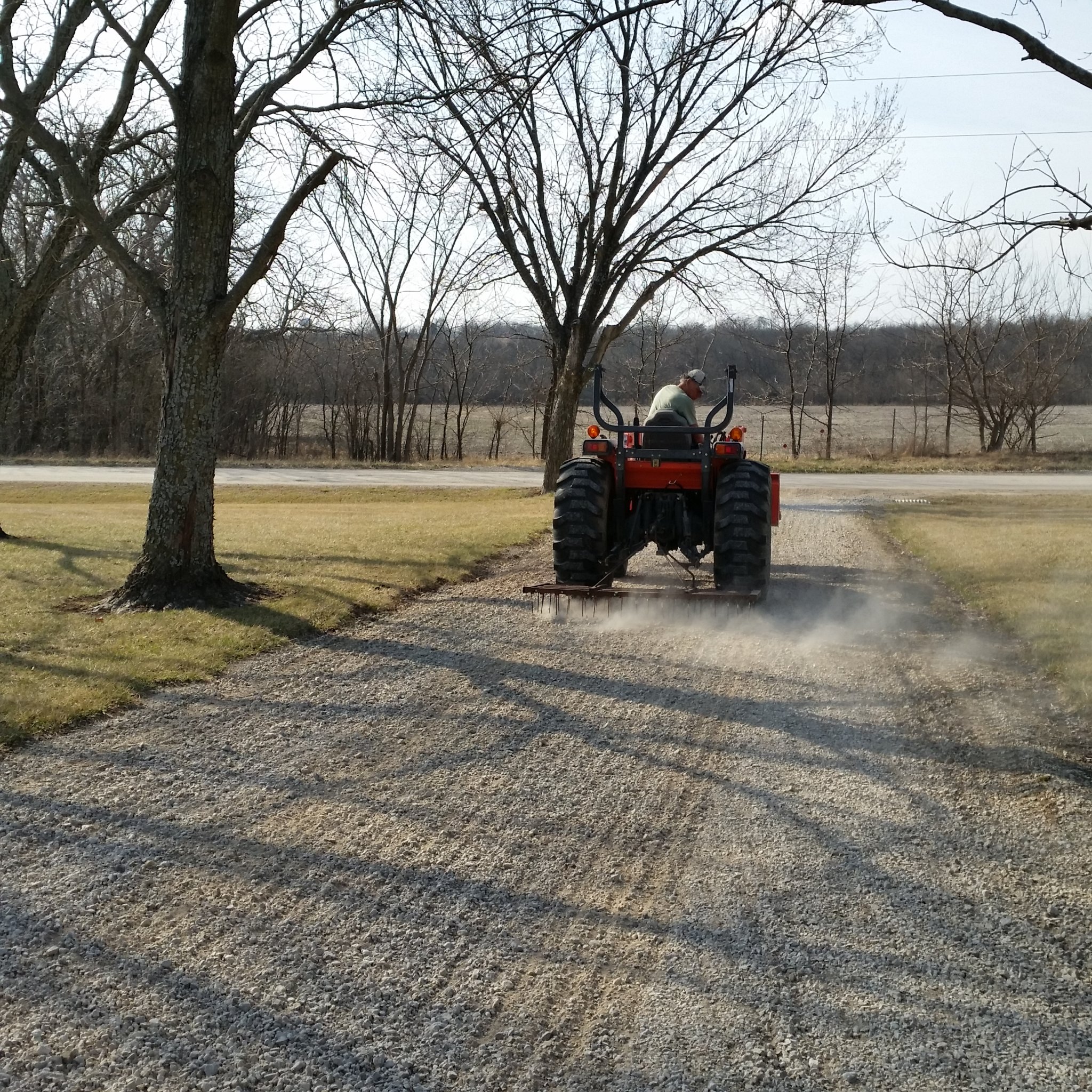

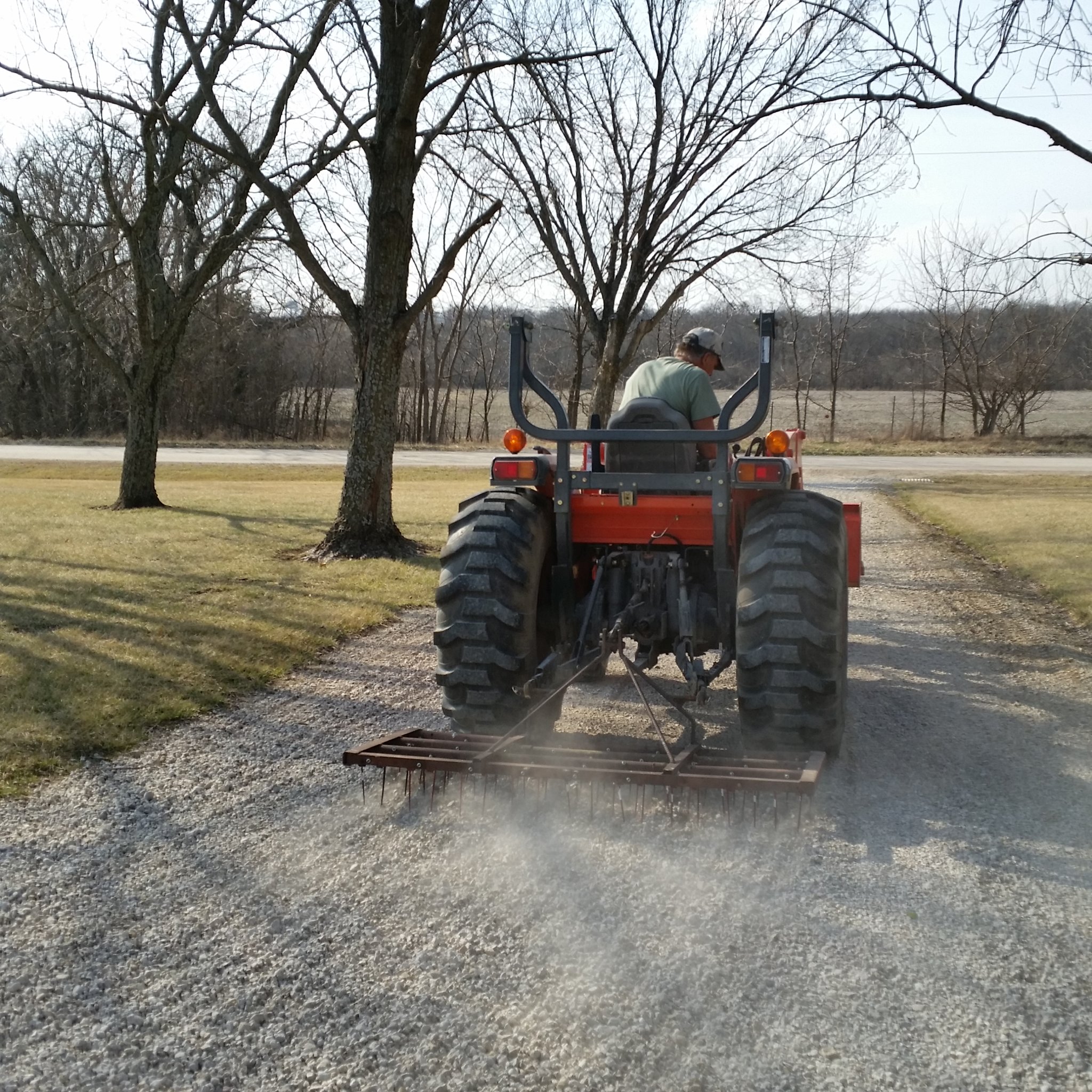

Thanks to all for your replies and the pics y'all posted. It seems like the cheapest route is the drag mat for smoothing out a small gravel drive.
Land Planes, I have heard, are fantastic; but it's hard to justify the expense since I already have a box blade that I need to learn to use better.
If I end up with more uses for one I'll get it, but for now I'll probably hold off and make a drag mat for a few dollars and some scrap metal.

Runs With Scissors, since you can fabricate why not build your own?
I've build a couple these and they work excellent. I use the pickup teeth from a hay baler. Doesn't matter if it is big round or small square, they are 6' wide, have four rows of teeth mounted on steel angle or round stock. Remove the entire row of teeth (as a unit) leaving them mounted as they were on the baler. Get all four of the reels.
Build a frame for the row of teeth. Use what you have, I used 1 1/2" angle. Basically 6'x4' frame. Then need the steel to make the 3pt attachment. Make it from scratch, or remove the whole thing from another piece of equipment. Bolt the 6' rows of teeth 12" apart on the frame you made.
Need to fabricate with the idea of need to replace the pickup teeth when one brakes or lost. I mention this because some balers install the teeth (round hole in the spring part) over a round tubing. I would pass on this design because it requires removing all the teeth in the way of the one needing replaced. Other models attach the teeth with a curled washer and bolt. Much better design because each tooth is independent of the others.
This implement works real good for working up rock in the driveway that has been packed down by winter traffic. A few slow trips and it looks like you hauled in tons of rock. (I've have had neighbors see what I was doing and asked if I'd do there, how much?) It look that good!
Also use for dethatching grass, or once it's dethatched use it as a rake for anything needing raked. The four rows of teeth are staggered and so it does a good job of missing nothing.
I basically have nothing in it for material, just time and it out performs anything I've seen that is similar to it. Check local scrap dealer for old farm implements for the baler teeth.
