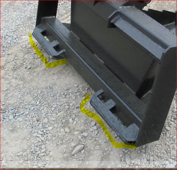

Thanks Wolfman! Would you recommend a thickness to not go under? I see one I like is 1/4". I'm told it doesn't matter what thickness the metal is, but more so the design of it
32,845
8,335
Yes, design is important, being that your using it on a tractor keeping the weight down is also important.
I would say 1/4" should work great.
if you look at this pic you will notice that this style of bucket is reinforced to not tear the mounts off, as you do roll the bucket to make it work.

Thanks Wolfman! I don't understand the difference however in the actual mount. I'm going to look into it again and compare the two.

I was pointing out that the bottom mount has a second plate to keep from coming loose while prying up with the bucket.

Got it Wolfman! Thanks again. I now understand about the second plate. Very good point.
