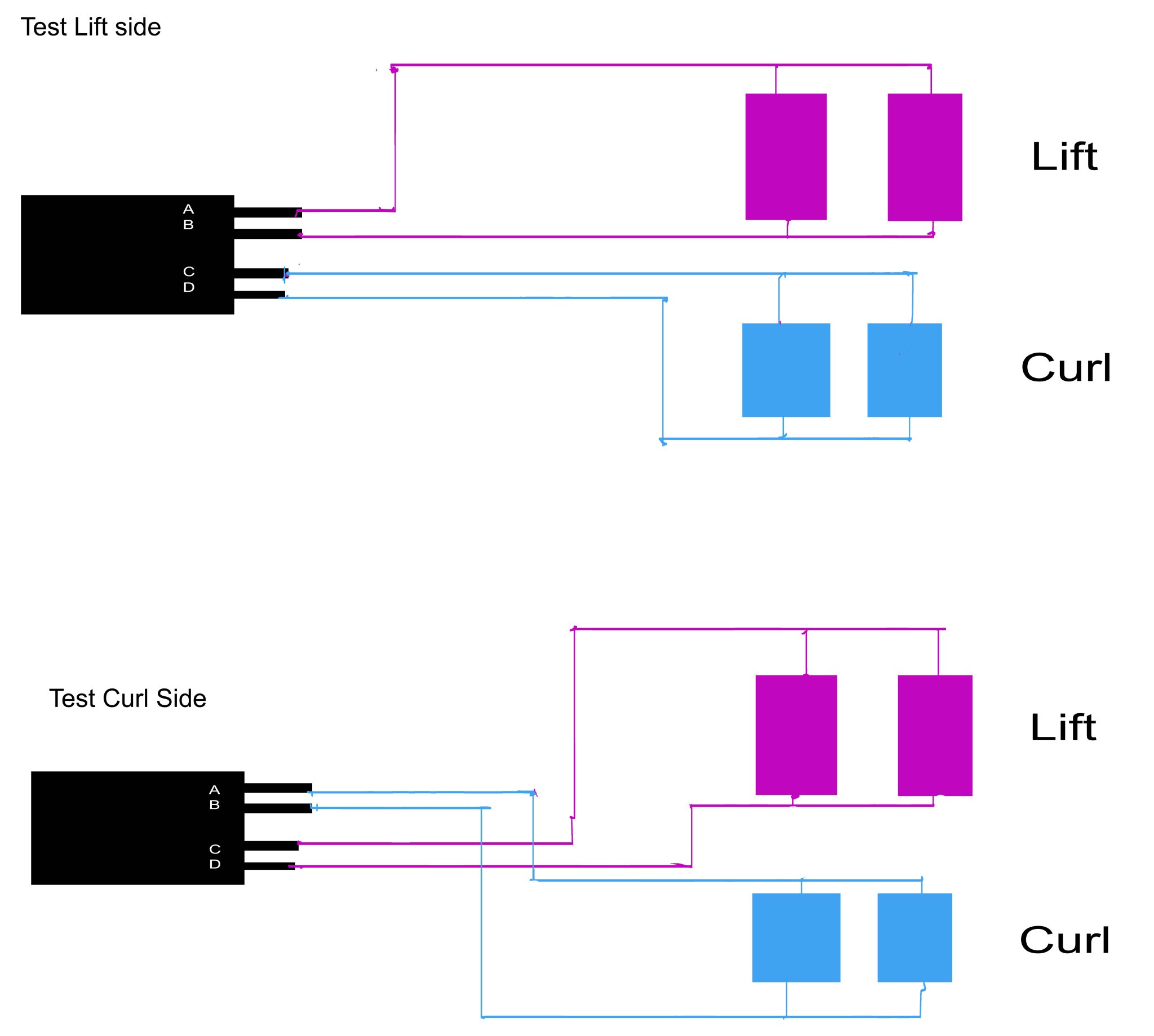

Let's try a graphic...
Okay, so looking at this, the black is the tractor side of the system. Valves, joystick, female connectors, the works.
The red is the lift parts; hoses, cylinders.
The blue is the curl parts; hoses, cylinders.
Since OP told us that when he swapped the hoses, the lift still worked and the curl didn't, then everything in black must be working. Also everything in Red. The only places the problem could be are now located in the blue section. Either the hoses or the cylinders.
Old Hokey said to disconnect the hose from the cylinder side, and then run the joystick to see if fluid comes out of the hose. If you do this for both hoses, then you have eliminated the hoses as the problems. This leaves cylinder. Since they are a simple T fitting from one cylinder to another, a failed cylinder that is shorted (i.e., oil just passes through without resistance) could cause it to fail in this manner.
Okay?
9,208
4,802
Okay?
Okay?
