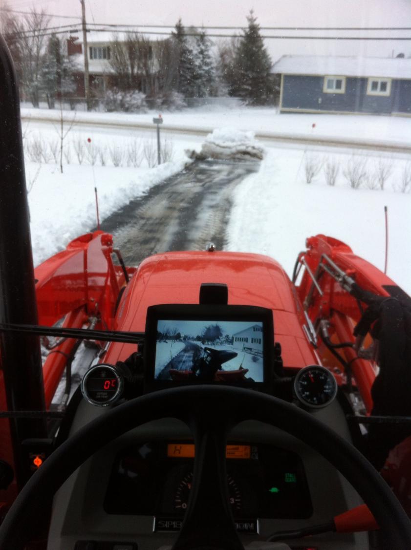

I was kind of elected or volunteered to remove the snow for the neighborhood. I had no comparison until this last week when we had an 8" snowfall. My neighbor has an older Kubota with a 5' back blade.
As we were both out there, it was clear I could push twice as much snow as he could. The plow is taller and the tractor had more traction. As he drove over the snow, he packed it down leaving behind tire tracks. When I went by it was pure pavement.
Now the big part, I can put snow exactly where I want it. Having a back blade and trying to make a turn, it tends to make a mess and a lot of extra work turning the blade around.
Now if you were simply clearing a straight driveway up one way and back another, a back blade may be the answer. I have to clear 2 streets with courts and the sub enterance. Hands down the front blade won.

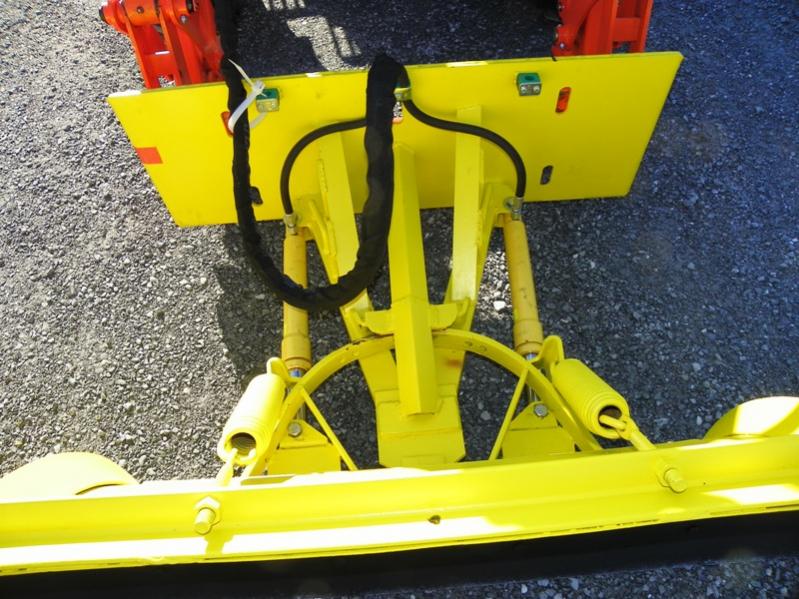

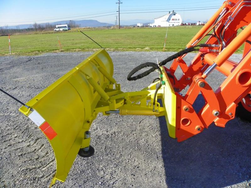

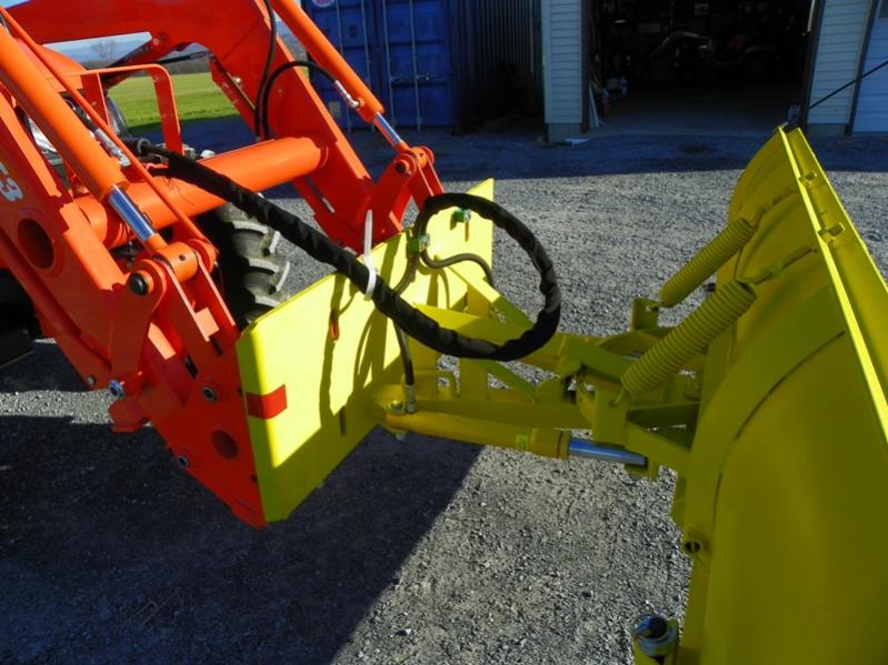

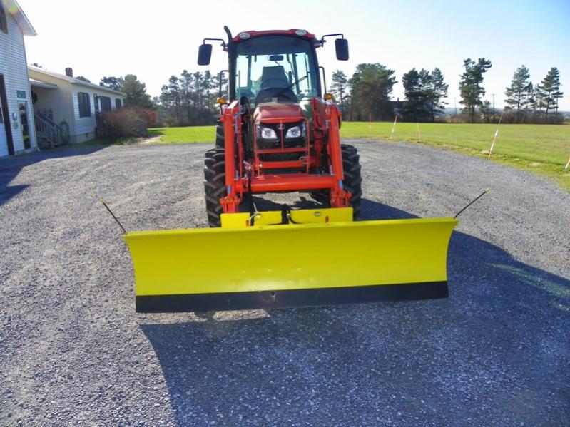

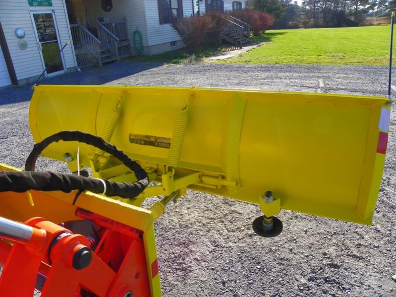

I used a old Truck plow (7.5 ft) and put it on our M7040. It should work on your smaller tractor just fine. Here are some photo's. This is a 1972 Meyer that I found out in the woods one day last summer.
