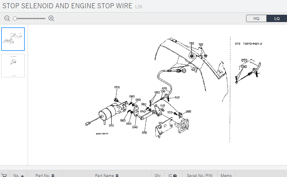

The stop cable has not been pulled right?
The stop solenoid is not activating while cranking is it?

The other day after numerous attempts at cranking the starter I checked the stop cable and it moves freely and is not stuck out.
