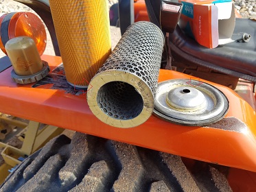

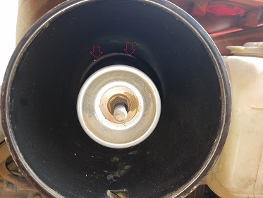

- I went to replace the air filter and d*mn it, it will not fit. I posted a few pictures of the old and new. Odd the original one looks like it have some sort of construction adhesive to keep the one part attached. Looking at the parts manual, it looks like they changed it. The air filter canister has an internal ring guide (?) and the new one is about 1/8" too wide in diameter... Plus it is shorter... Still trying to figure that one out. I am just going rinse out the old and put it back in to buy some time. Maybe someone can help me with quick fix or point me in the right direction on that one.

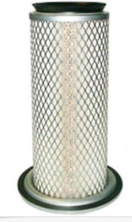

TA DA!
Sorry Wrong filter :eek:
That's the filter for a single filter setup, you have a dual filter setup.
Outer filter: P/N 32751-96260
Inner filter: P/N 32751-96270
Normally the inner filter only needs to be changed every blue moon.
And yes the metal cover is glued to the filter:

my L35s air filter does not have the glued on metal cap, it only has the rubber on both ends.

Other than your filter woes, NEVER, NEVER rinse the inner filter out with anything. Like Idaho Wolfman says, replacement of the inner filter is basically never.
Don't rinse the outer either. blow it out with low pressure compressed air from the INSIDE OUT.
