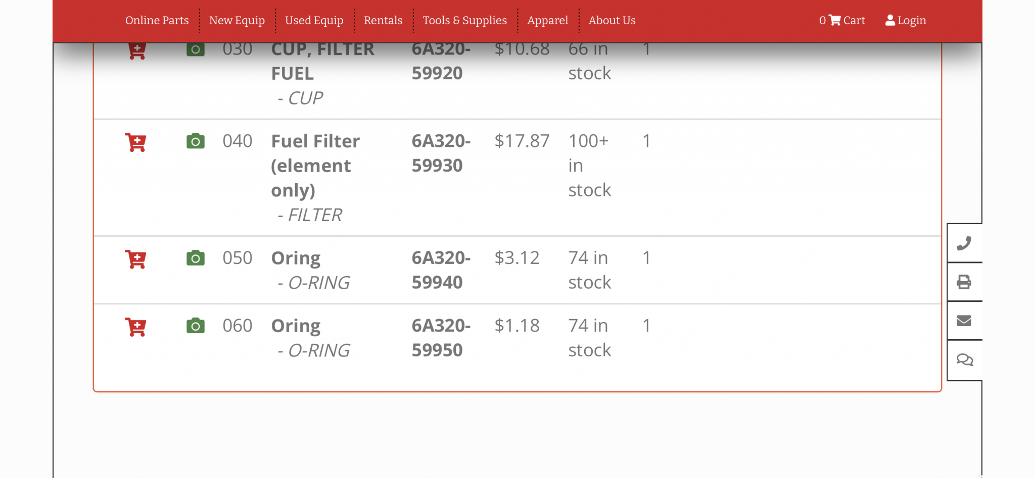

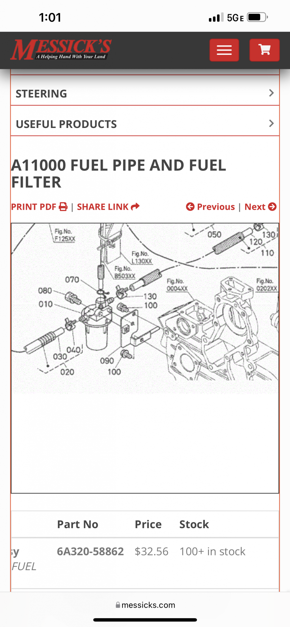

I was thinking what wolf man said.
Was going to suggest if you plan to change filter then just change the whole filter housing assembly. Its not much more then the filter and o rings
