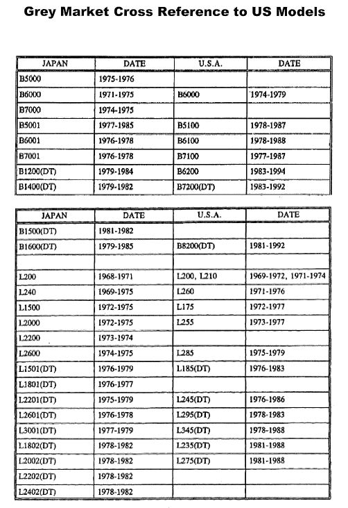

Is the L3001DT similar to a Kubota L285, L295 or L345?

The L3001 would be similar to the L345;
