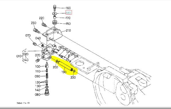

I've found the source of the leak. It's not my fuel tank. In the picture below, you'll see a short pipe leading from the hydraulic valve back to the transmission. The leak is where the pipe goes into the transmission itself.
Does anyone know if this can be fixed from the outside or does the trans have to be split? I bought the shop manual but I dont know what that pipe would be called to find it in the 650 pages...
