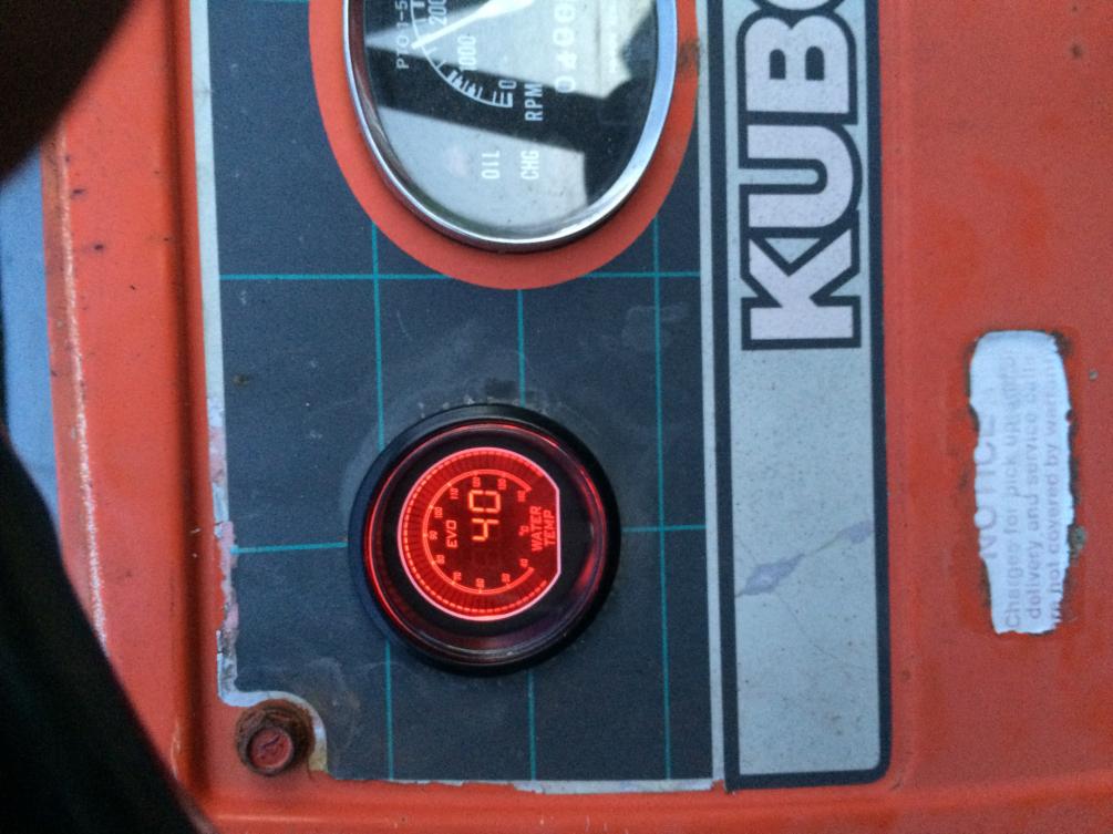

I have the gauge installed. Still waiting on the adapter. The sending unit is 1/8 NPT and the Plug in the head is 3/8 BSPP. I was able to find an adapter from discounthydraulichose.com. I ordered a couple extras because I have a couple AMSOIL Bypass filter kits laying around that are old stock and I want one to install on the tractor.
http://www.discounthydraulichose.com/9035_BSPP_x_NPTF_Female_p/9035.htm
The Gauge and Sending unit I got from EBAY. Depending on how you connect the wires you can have it blue during the day and red when you turn on the lights or vise/versa.
http://www.ebay.com/itm/Smoke-Len-2...4910028&pid=100005&rk=4&rkt=6&sd=251582305774
I will post pictures once I am done.

Here are pics of the Gauge. I thought I order Fahrenheit gauge instead of a Celsius, but its better than waiting for steam to come out of the radiator.
10,352
2,170
thats pretty cool and ....COOL!:)
think of it this way.....100 is NOW your new scale ....if'n you see it get to 100.....you are getting rather HOT (212) ......so I would expect it to be right at 95+ under normal conditions....maybe getting really close to 100 C :)
I would hope that it would get to 85 and stay there, you need the heat to cook off all the moisture in the oil and have an engine that works well.
