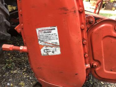

Hi all. Just picked up a Kubota tiller, only to find it’s one of those “grey market” kinds, so I don’t have any working documentation...not in English, at least.
Question is for maintenance. I assume it’s chain-drive. There’s a filler cap on top, and a bolt on either side. I am guessing the the bolt on the lower left is a fill level check hole? The extension on the right....draining? 90-weight gear oil should be OK?

I think you have it right. The higher plug would be filling and the lower one is a level check.

This is just a guess but I think the one on the right is not for oil but is to tension the chain.
