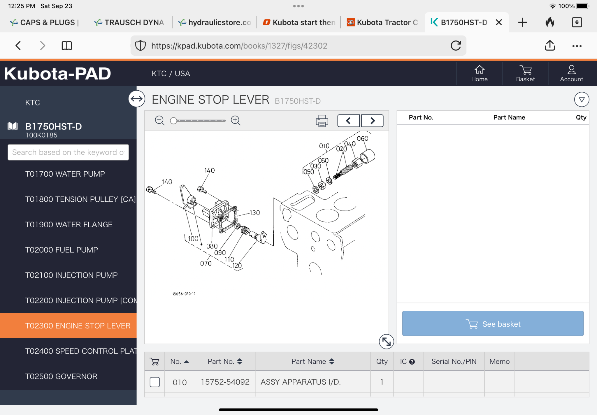

I'd begin with making sure kill leaver on pump is moving full stroke.,solenoid might be malfunctioning. If you have both electric solenoid and manual pull knob,disconnect electric solenoid until this problem has been nailed down. You might even disable solenoid and operate lever by hand at the pump.

You need not be ashamed you don't know how to maintain your tractor but you should take stock of your willingness to pay attention,follow instructions and learn before asking others to teach you. You are hung up and arguing about the very first thing you were told in the first sentence of first response 4 days ago and shown a picture of in post #4 three days ago. I can't stake my life on your tractor having a lever that kills engine but I'll stake my reputation the tractor had one from the factory as pictured in upper left corner between screws numbered 140 and I'll wager 3 to 1 the lever is still present. What do you call that thing that is pushed and pulled by the solenoid you replaced on the advice of "some others"? Troubleshooting is a step by step process of testing,not helter-skelter parts replacing. As for your certainty the problem is electrical, it might be but it requires less time and money using an organized process to find out than acting on guesses. Your tractor will start and run without a battery so don't become engrossed by electrical doo-dads. You might consider that harsh but not near so much as when my elementary teacher slapped me before telling me to set up straight and pay attention or allow her to set in my seat while I teach class. So do you want us to help you figure out what's wrong or question our advice?
