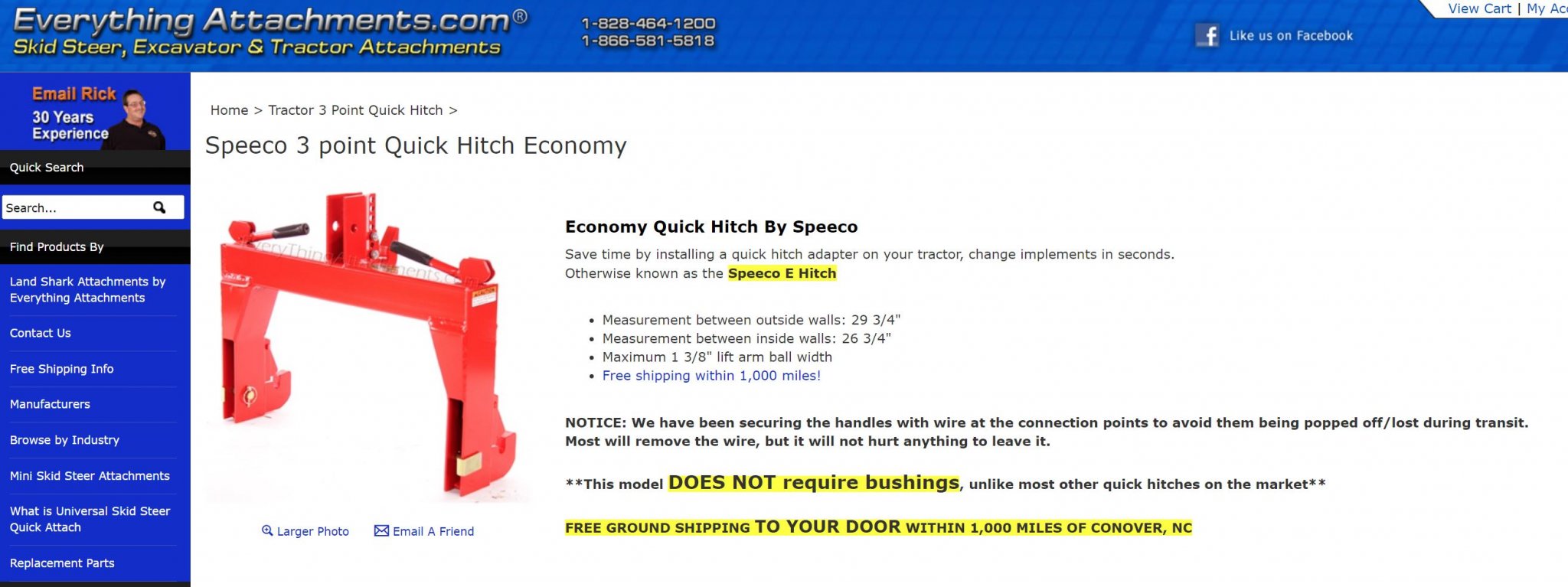

alternatively, this one works quite well and is Cat 1 with adjustable top hook (and very reasonably priced). https://www.everythingattachments.c...nt-quick-hitch-by-Speeco-p/speeco-qh-econ.htm
edit: I just noticed that in the above link, the description actually states that no bushings are required. See highlighted text in pic. Maybe it will help someone else.

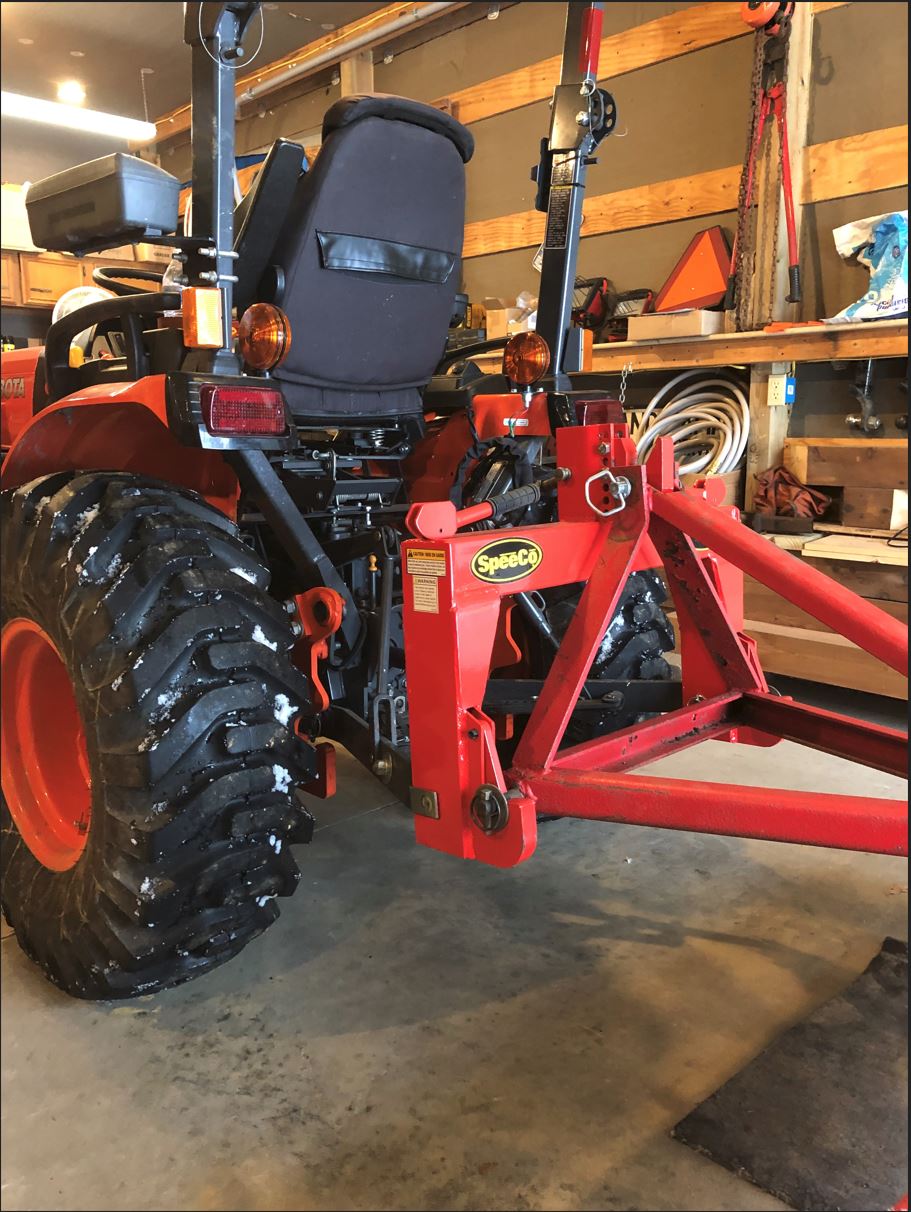

Here is a pic of mine (Speeco E Hitch) that's "economy hitch" with a rear blade off of an old 8N. Note the 7/8" pins of the rear blade fit pretty well in the quick hitch.

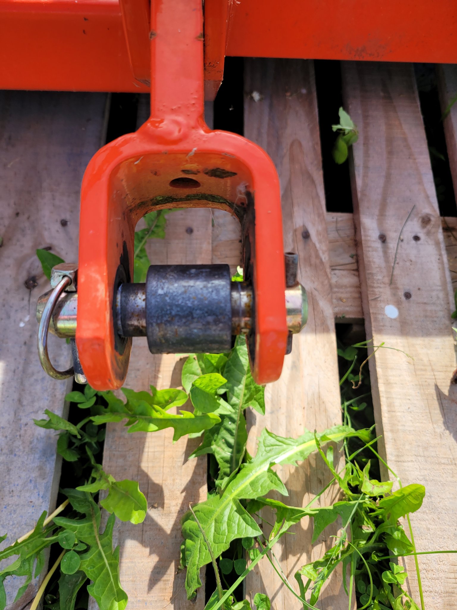

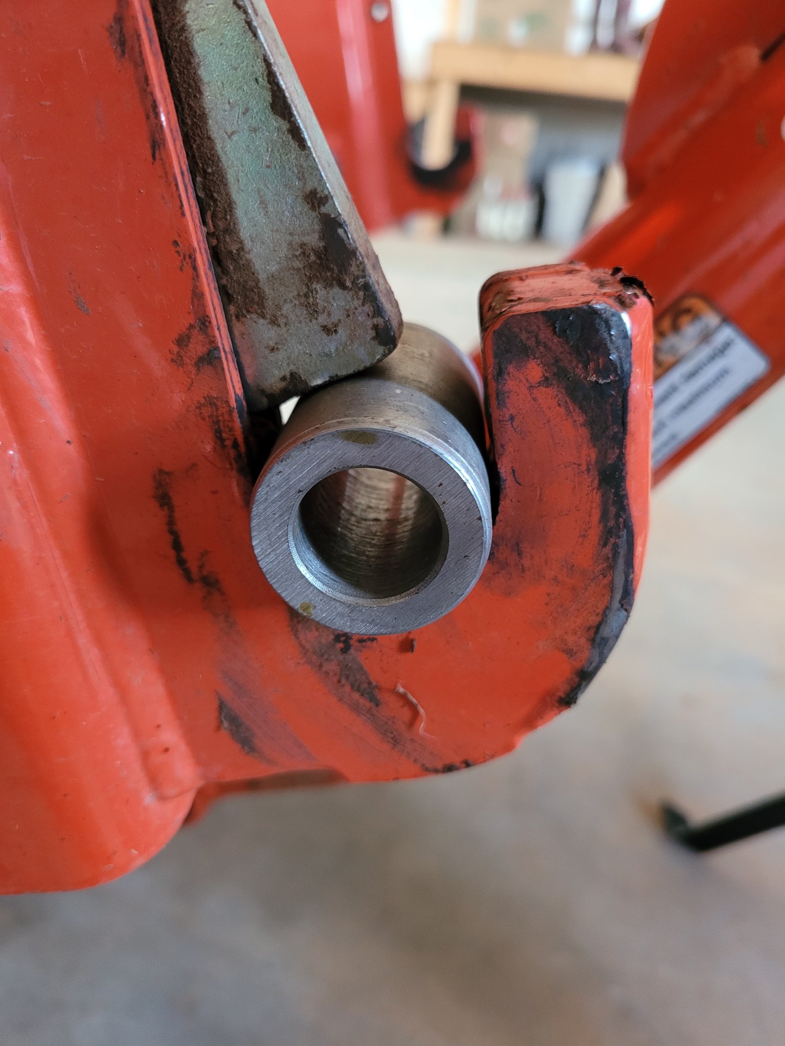

I had 2.25" long bushings made but you can also get them through Kubota. Attached is a part number for 1 5" landpride bushing pair. Pics of a bushing in the QH and on my mower.
