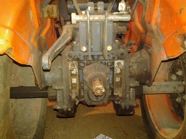

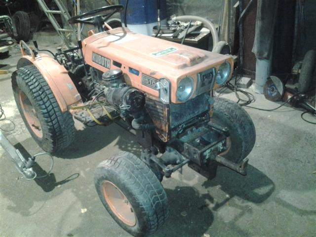

Hi there! I am from Finland and I bought a Kubota B5100D 79-84 model tractor last month. The engine is a model Z500 and it lacks the injection pump 2-cyl. Do you find the spare parts here? Finland did not exist .. I also need a bench and lifting equipment parts. Thank you! Sorry for my bad English, google translator .. =)

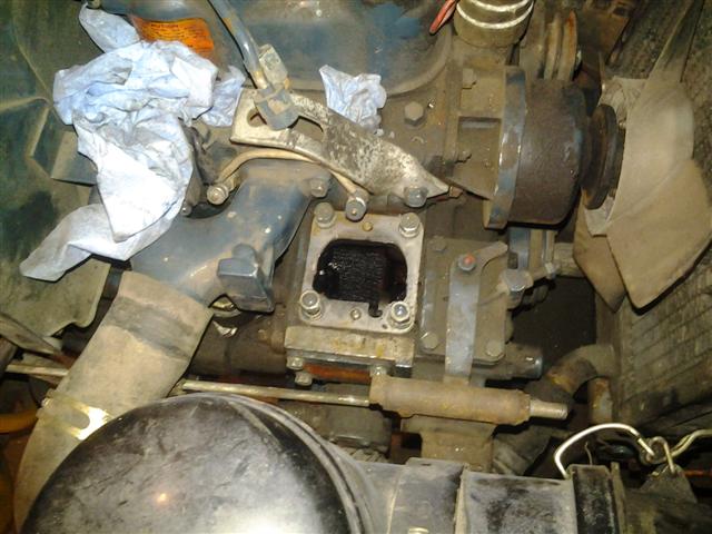

Hello again! Anyone know what is this injection pump model? Bosch, Zexel, Nippon Denso or what is it?
-Esa

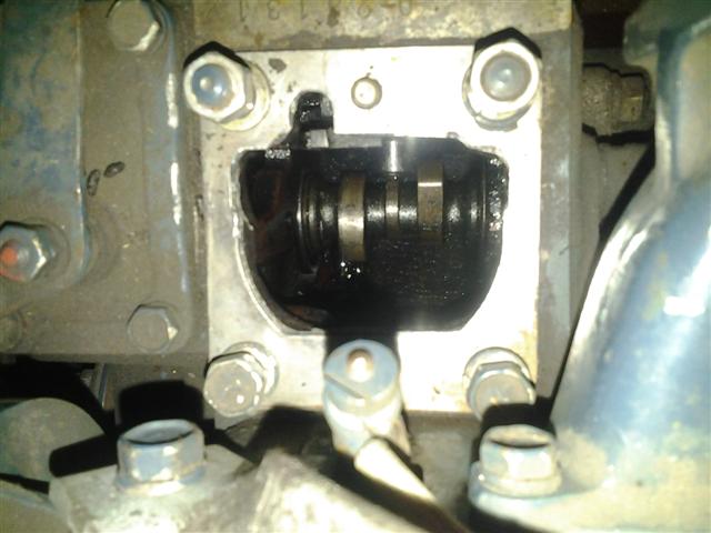

I buy a new injection pump from Finland. 550EUR... But my kubota dont still work. Not pressure in cylinders. Start good but doesnt work. White smoke in exhaust...No air in fuelsystem...
Can i do something in valves? Or change new valves and pistons..?
T: Esa

Does it start?
Does it run for any length of time?
Is the fuel fresh?
Can you post a video?
Did you put any shims in with the injection pump?

Have you checked the engine timing??
Is the pin in the rack on the pump in the slot in the yoke?
Are both springs connected?

Hello! And thanks for answers!
Not run any at all, fuel is fresh, compression relase is ok, pin are ok but I remember that I could only see one spring.. Two?
What it is shims?
the timing I have not checked yet..
the exhaust pipe to suck and blow when trying start. Valves?
Sorry my bad english.. =)
