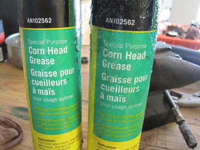

After doing days of research on leaking gear houses on implements, I came across John Deere corn head grease. I even found a video on youtube that I included the link below for you guys interested in seeing it. This stuff looks amazing. Stays in place much better than traditional gear old. If you have a bad seal, it won't leak out without you realizing it until it's too late like regular gear oil. The +'s just seem endless on this stuff. My local JD dealer sells it for $3.50 a tube. I'm planning on using this in my new bush hog arriving tomorrow and may actually change out the gear oil I have in my roto-tiller and auger gear heads for this stuff.
Anyone have personal experience with this stuff. Do you recommend it? I called my local Kubota dealer and asked if Kubota sells anything similar. They said no but highly recommended the JD corn head grease as well.
Here is what a tube looks like.
