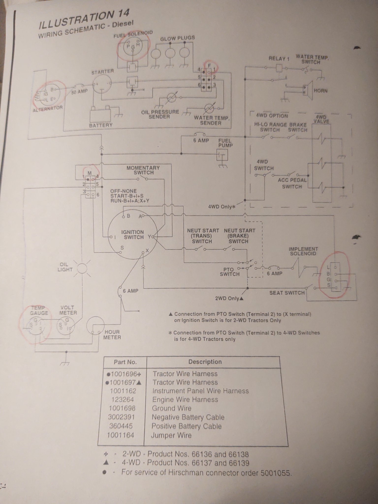

I recently purchased a jacobsen turfcat with Kubota engine. I'm trying to understand the wiring diagram.
I'm not sure of what some of the letters on diagram stand for.
I circled them in red.
Fuel solenoid p g h
Alternator. Ig b l e
Gauge s g I
Connection blocks. M F lBGS

Fuel solenoid p g h
P = Pull in
H = Hold
G = Ground
Ig = Ignition
b= Battery
l = Light
E = Energize
Gauge s g I
s = signal
G = ground
I = Ignition
They are connectors
lBGS
Looks like a interconnect / safety relay.

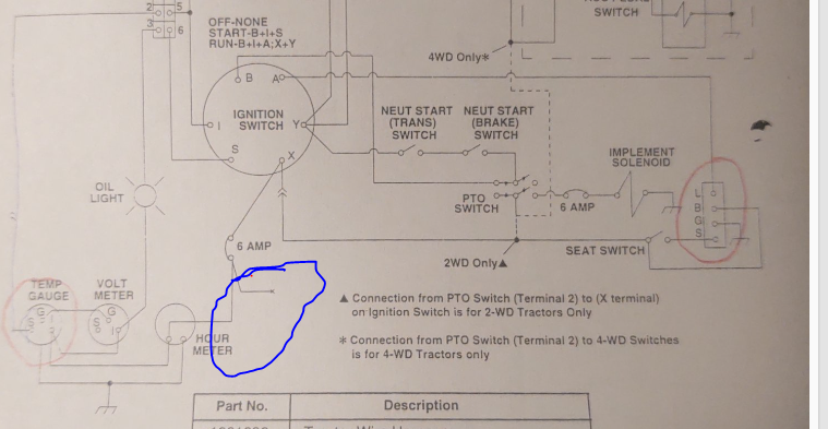

Thanks for the answer. Everything makes sense. I understand how everything is working , except the lBGS.
It makes sense that it is a safety relay.
It is connected to the seat switch .
But I can't seem to figure out how it stops engine from running?

Also I didn't know where the one line is going to. I circled it in blue

That blue connection would be an optional connection, like for an add on.
The way the relay works
S and G and B are inputs
L would be the output that feeds back to the switch.
G and B would be the coil
S and L would be the normally open contacts
The seat switch activated keeps the engine running.

Male and female , duh, I'm hitting my
Hand on my forehead!
I get how a relay works and when you
Close the seat contact it energizes the coil and you get a output on l that goes to A.
I don't see a need for a relay
Usually you use a relay for a holding circuit , or one input to control multiple lines, or one voltage to control a larger voltage , or current.
So you don't have arcing in the switch
In this case the seat switch. But the input to the relay is just the same wire as the control signal. If you ran the out put of the seat switch to the A terminal it would be same thing.
I also don't get that you need to be sitting on seat to start it. You sit and get the voltage to the A terminal on the ignition switch. But A doesn't even come into play when starting
It says start is B I S. I'm missing something here. Thanks for taking the time to explain this ,it's appreciated

I'm pretty sure it has to do with the operation of the PTO switch.
Normal operation will kill the engine if you get out of the seat with the PTO Engaged.
There just are not very clear to the operation.
I'm betting I have it backwards on the relay and it might energize when leave the seat and thus cut the run signal.
It's hard to tell from their diagram as it doesn't state N.O. or N.C contacts.

It shuts off the fuel.
JimDeL
Aug 31, 2022
224
224
Austintown, Ohio
It activates a solenoid which is connected to a fuel shutoff valve.
I'm not familiar with the Turfcat, but generally there are various safety switches that sense the operator lifting off the seat while the PTO is running, or the throttle/pedal is off its neutral position, and shut the engine off as a safety precaution.
