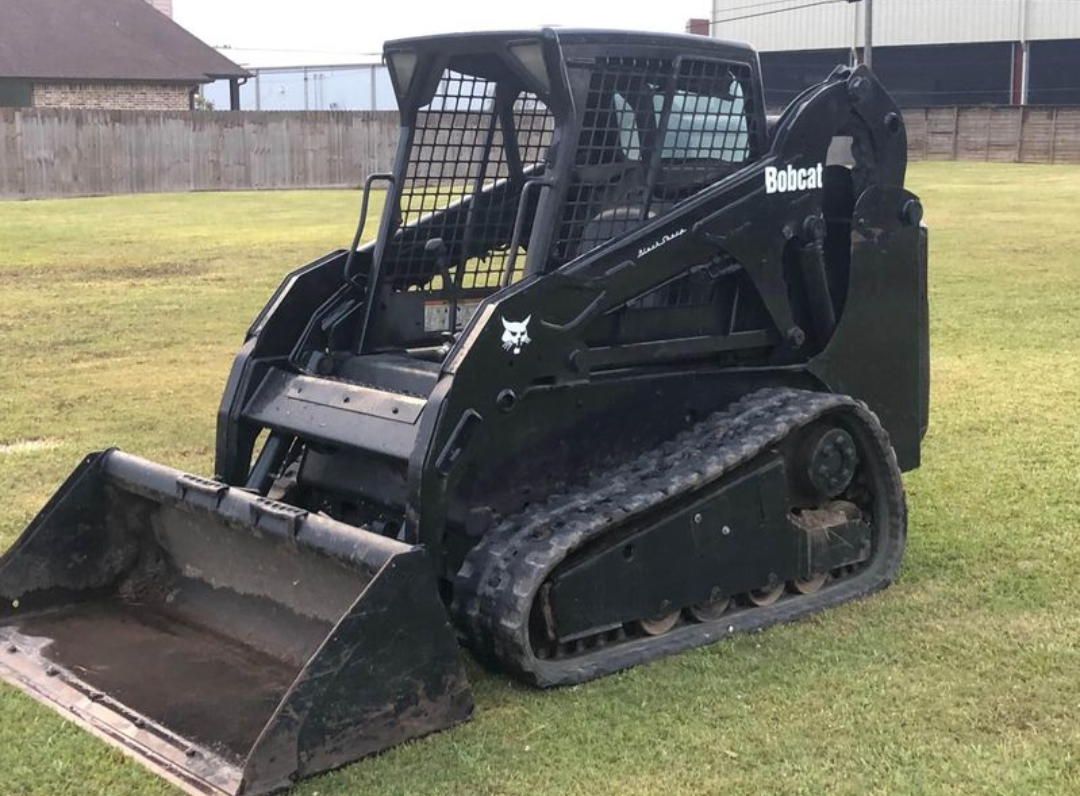

Where were you yesterday? LOL.
I've been contemplating getting a SS for quite a while for the forestry work I'm needing / wanting to do, so this will scratch several itches.

Correct solution. Is that the stealth model?
I thought the same when I went searching. LOL.
I told wifey I can't leave it out in the woods or we may never find it again.
May do some orange and white camo overlay on it. 😆
