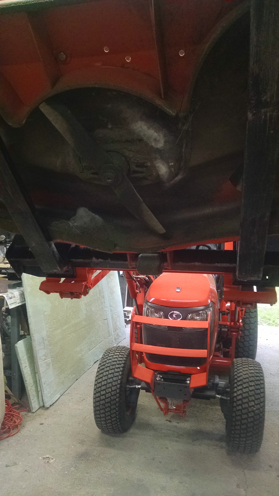

Beginning of the season I pull the deck up to 90 degrees and check out the blades. If they look decent I do not bother, if they are beat up I'll have them sharpened.

This is a good question. I bought my new B2601 About 1 year ago and just took the mowing deck off for the first time in conjunction with performing the 50 hour service. The bottom had crud built up as expected and the blades were quite dull. I attempted to sharpen them a bit with an angle grinder without removing them. I give my effort a D- . The deck seems to cut the same as when I first got it and both before and after my feeble effort. I am not a lawn keeping professional so take it for what its worth. My yard looks as good cut wise as the neighbors who employ professionals.
