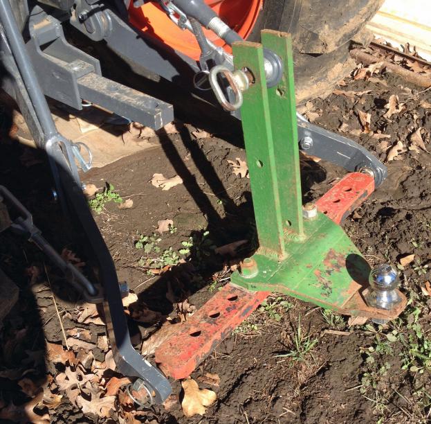

That's pretty neat! I did it the hard way and welded the adapter directly to the bottom plate, but only spent $10.:D

I bought a 3 pt hitch adapter (homemade) last fall that's working out great. When I need to attach my trailer, ect. I just back the ball under the receiver, raise the 3pt and I'm good to go. Move out the trailer and secure the ball. Starting with a draw bar and a little fab'n to complete the 3pt and that's it.

Seems Im not the only one, I found an old trailer receiver hitch laying in the pile of trash one morning, had little brother cut it up and weld it to a plate, I marked and drilled it, and never looked back,, They should come standard on the BX
