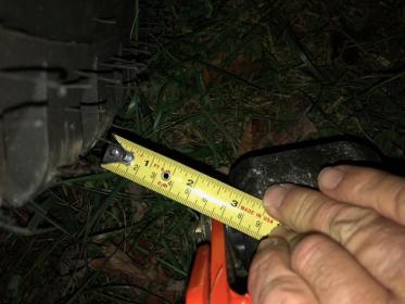

Hi Manvito,
Bro-Tek sent another set and they don't fit either... they look almost exactly like the first set they sent, but it's the same part number that you mentioned worked for you.
If you have a few minutes, would you mind measuring the inside diameter of your wheel hub? Bro-Tek says their spacers have a flange on them that should fit inside the hub opening and allow the weight of the wheel to be bore by the spacer, not just the lug bolts. But, in both sets they've sent me, the flange on the spacer wont fit through the opening on the hub.
Thank you,
-Michael

Hi Manvito,
Thank you,
-Michael
I’ll check them out when I get home. Here is a picture of my spacer and my hub, I’m going to assume that they look the same as yours.
