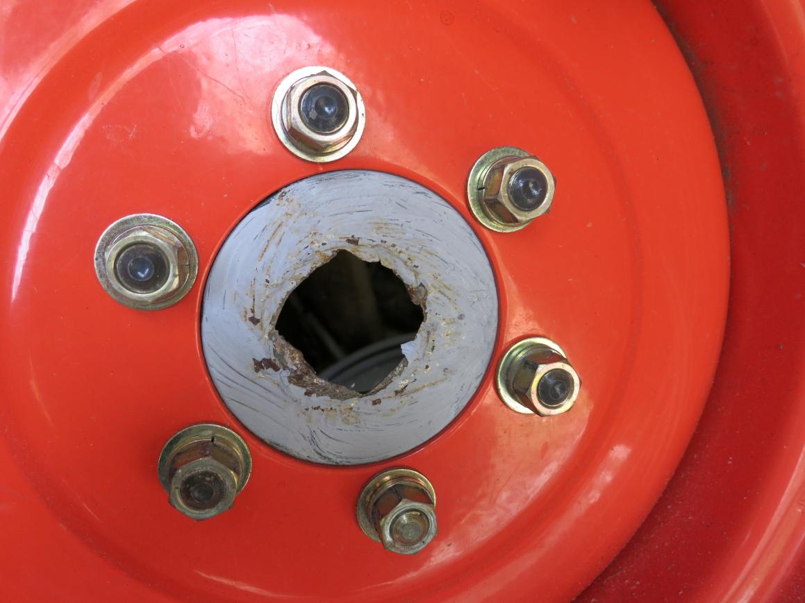

I was driving along and the front wheel fell off. i took some pictures but I dont know how to put them on the forum.

I am assuming you mean your tractor and not your car,, Soooooo how did it fall off did the lug nuts come off, the axle come out of the housing did the tire come off the rim,,, a little more information if you please and what would you like to know?

Sure you can fix this yourself. it just depends on how mechanically inclined you are.
You could remove broken axle shaft and have it reweld to axle flange. Or buy a new axle shaft (that is what I'd do). At Messick's the axle is around $162.00 http://www.messicks.com/part/32721-57323/shaft-front-axl

That looks like that had rusted out for some time. I would go back to the place you threw down $800 and say WTF you missed something. Had they taken the wheel off they should have seen that problem.

I doubt a shop would have caught that. A decen machine shop could fix it without a great deal of work. My local machinist would charge me 100 to fix it. I know he has a jig to weld shafts square to plate.
That being said, a new replacement would be ready to pop in. No waiting on a machinist. For the money, it would be the easiest route.may need a bearing or two, a couple seals and a snap ring or two. That all depends on what you find when its all apart.

Looking at the third picture, it looks like it was broke and welded up once already. Either way, I'd be replacing it with a new axle.

besides the rust, I'd assume that it takes a pretty big side load to break an axle like that. someone in that tractors life may have been pretty rough on it.

I really appreciate all the help. So when I order the new axle I should order two bearings, two seals and two snap rings to make sure. I hope one or some of you will help me through this. Thanks a bunch. filix.

For $162 I think I'd opt to replace the shaft if it was my tractor. Your tractor must not be the 1st one to break as Messick's shows to have 4 shafts in stock.
