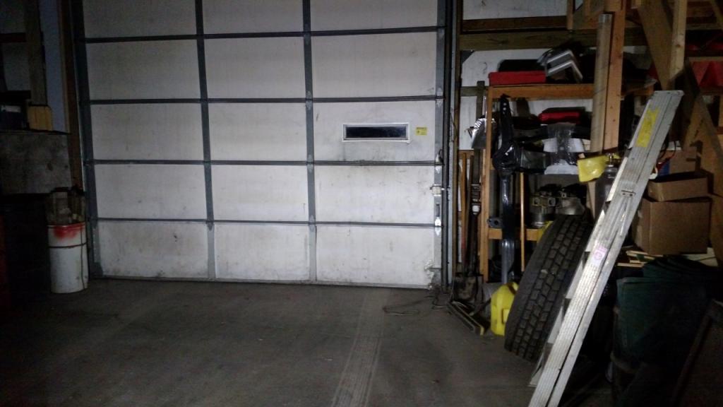

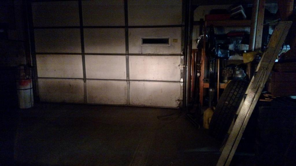

Like vic, I'd be surprised if the factory lights were adequate. I'm on my third Kubota and as happy as I've been with most everything else, the headlights have all been pretty sad.
Even the factory work lights on my L4240 didn't make the grade and have been replaced with LED's. They delivered spotty / splotchy lighting patterns.
For plowing and loader work, high-mounted LED's work for me. For mowing, the best light is from a pair of LED's mounted low on the grille guard. The low lights make seeing the cut line much easier for me.
