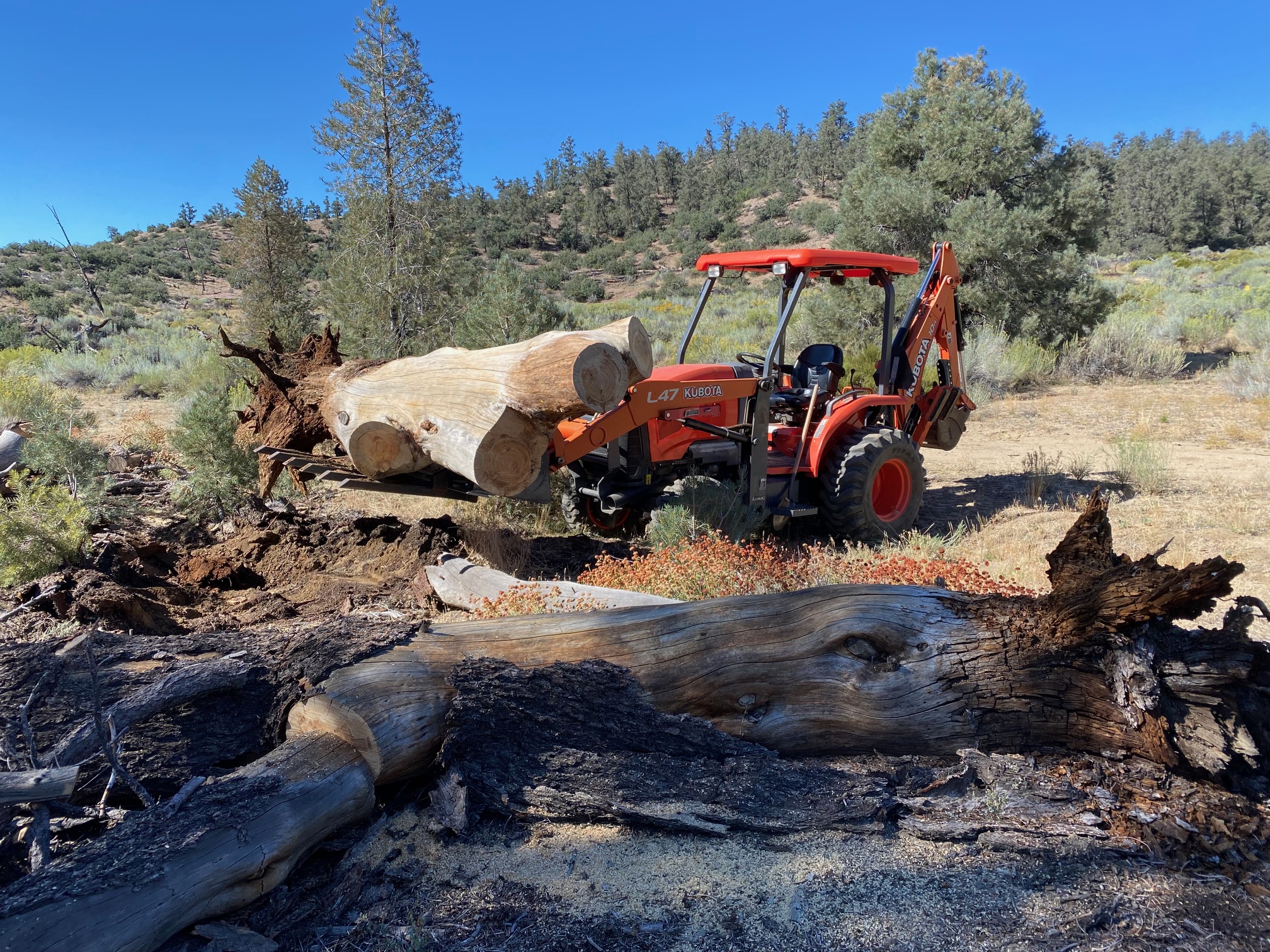

I want to move some cabled tres from my property.
I'm looking for pricing on grapples and they seem pretty expensive ($2k-$3k). Has anyone found anything else that works similiarily for moving piles of trees?
I'm struggling with what "cabled tres" is
Your tractor is a little small for moving "piles of trees"

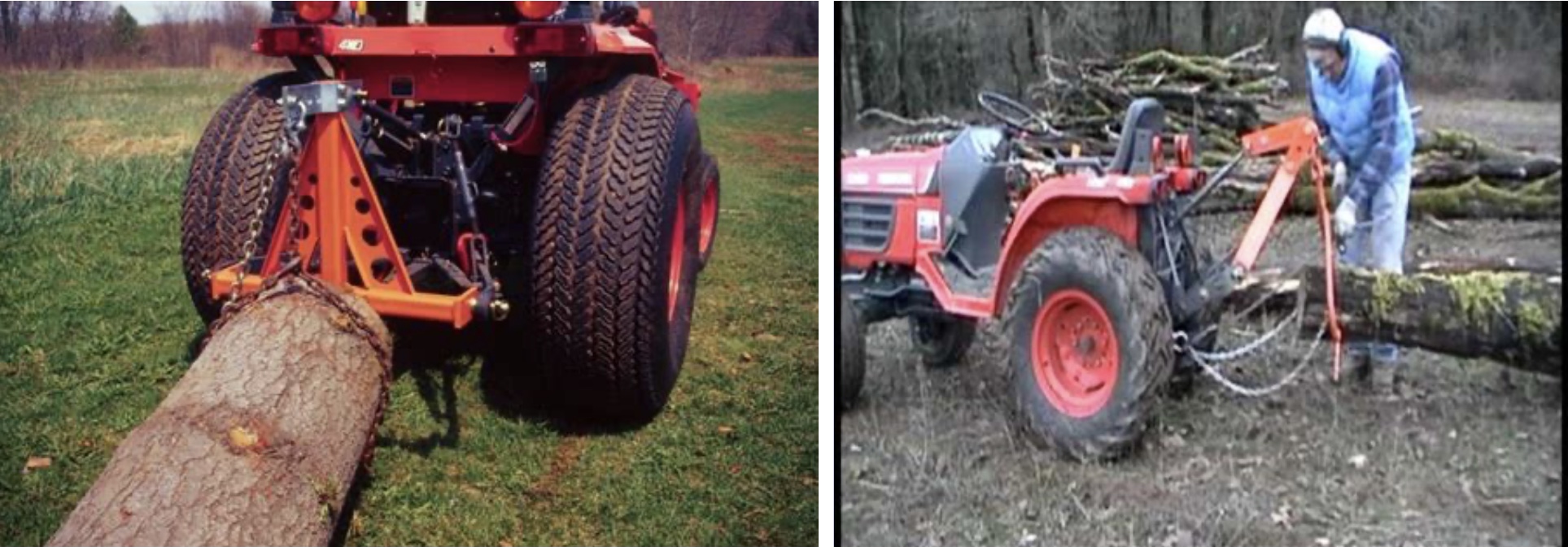

I'm guessing this is what you are looking for to skid logs
Cabeled trees, typo & corrected. They're trees that were torn out the ground with cables & left in piles. Ranchers did this to Juniper trees for their cattle thinking more pasture grass would grow but it only created erosion.
Don't want to skid logs. Junipers arent like pine that are 20 ft long logs. They're branchy trees that are up to about 10'-20' tall.

Well, that additional info does make a difference.
Yes, that sounds like ideal for a long bottom grapple. If you go that route I’d budget about $5K to add a third function and purchase a decent grapple. Yes, you can probably cut some off that if you get a good deal on a grapple, plumb the third function yourself, run the third function off a rear SCV if you already have one, etc. but a $5K budget is realistically what I would suggest for planning purposes. Of course you could recoup part of that by selling the grapple when you’re done with it.
Or you could rent a mini ex with a thumb. Don’t know what that would cost but suggest looking into it and considering as an option.
Personally, I’d still try it with forks first. Even if it doesn’t work, you don’t have a bunch of money tied up, there are a plethora of other uses for them so they’re the kind of thing you’ll almost certainly wonder how you got along without them after you’ve had them a while, and if you find you never use them you can sell them for about what you paid for them as they don’t lose value so long as they’re in good condition.

Juniper trees. Forks may well work better that a grapple, depending on how bushy they are.
What’s the point of moving the trees? Are you going to put them all together and burn them? If so, a dozer would be pretty efficient at that.
