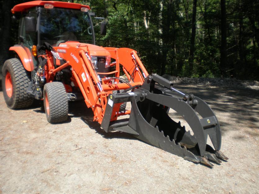

I have a Stump Grapple Bucket advertised in the classifieds on OTT. I paid almost $1600. for it with shipping. Most new go for $1500. + I posted a few pic's for you to see and the 3-rd function hose hook-up.
