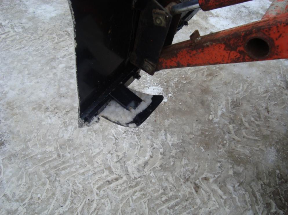

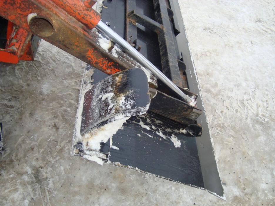

Hi Greg. Is what you are thinking of a blade that would pivot down in front of the bucket and hinging above and behind the bucket. If so are you thinking of making them into a separate quick attach system to switch between grapple and blade or integrate them so that the grapple is permanent and the blade can pin to the top of the grapple in some way. This is a very Coool!! idea and you really need to keep us posted on your plans. P.S. I am including a pic of the huge skid plates I had to build to keep that blade from heading for China.......Dusty

Dusty, you're on the money on my line of thinking. At first thought, my blade would have been a separate quick attach piece of equipment. But then I realized the most difficult part of that build is the hinge/quick attach part of it. Since I will already be designing and building this into my grapple tines, I figured I would simply design the tines with holes to quick attach the blade. I will be building 2 sets of grapple tines, short for holding logs and rocks and the like, and a longer 3' long pair for hold brush and branches when I have fork tines mounted on the bucket. I will have a very modular tractor this time next year!
This build will happen, but not until I get my tractor in good running condition. But I will post plenty of pictures. I also like the skid plates and will incorperate them into my build, thanks for the heads up on that.
