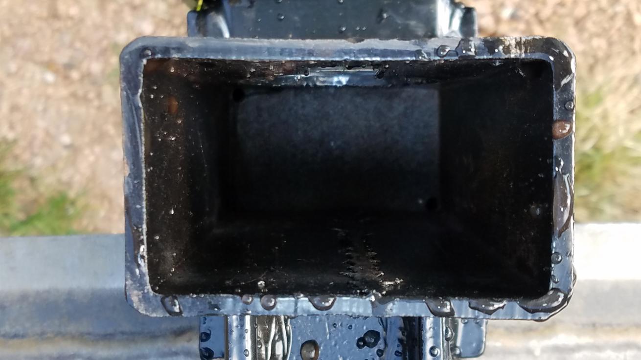

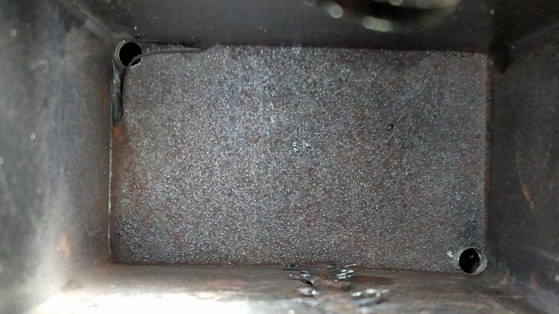

Washing the bucket and forks today before removing them
I noticed a place where water can be retained and cause rust.....
Drilled two drain holes diagonally front and rear for drainage.....
Probably need to shoot some black paint in there also :D
