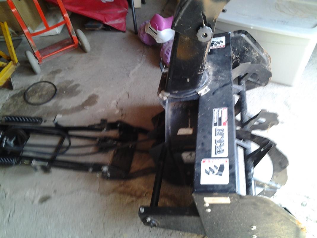

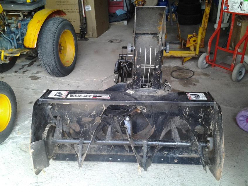

I apologize if this has been covered elsewhere, but I couldn't find it using a search. I have a B6000E I will be using as a dedicated snow removal machine. Where I live, we average 200" of snow per year, and there are many years in which we receive 300". Yep, walking behind a snowblower gets old pretty fast. I actually have a couple of questions I hope to have answered here:
1) What is the rotational direction of most (small) 2-stage shaft-driven snowblowers. I have seen a couple from John Deere. I am considering one in a 42 inch wide range.

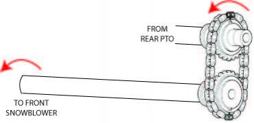

2) I am thinking of having a sprocket machined to fit on the CCW B6000 PTO Shaft. This would then drive a roller chain and another sprocket to turn a driveshaft going to the front of the tractor (like the picture below) The driveshaft would be supported by a couple of bearings mounted below the tractor frame. If the PTO is CCW at the rear, the driveshaft would be CW at the front. I know the drawing is very simplified, and there will likely be a lot of stuff in the way, but does this solution seem workable? I would like to know your thoughts. In my experience, electric clutches and belts are less reliable than driveshafts.
