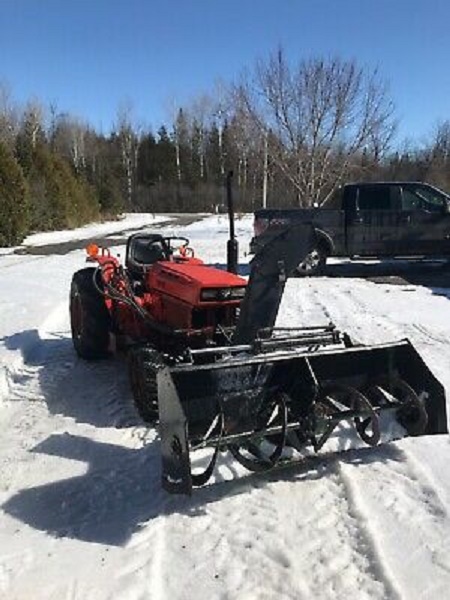

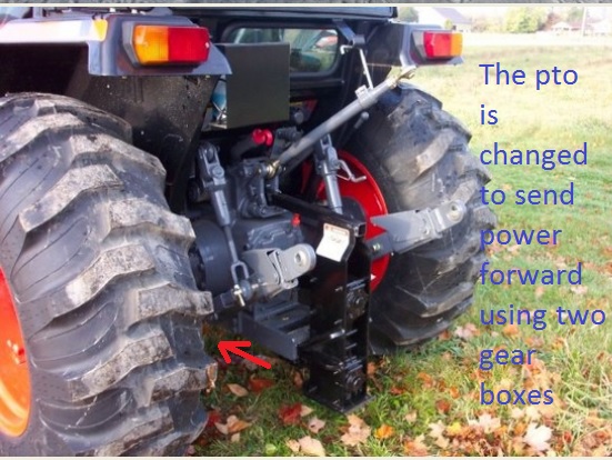

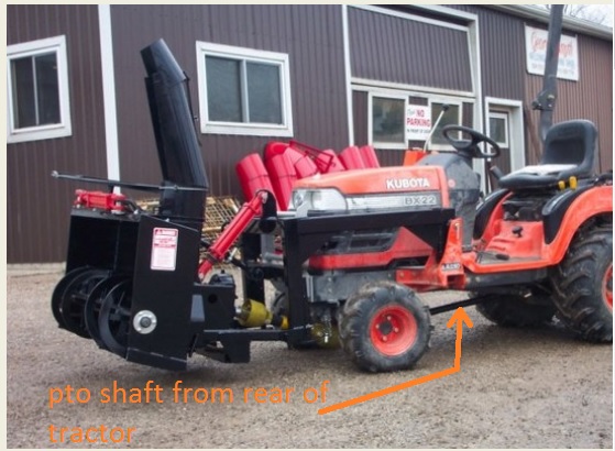

Smyth Welding in Canada has been making front mounted blowers driven from the rear pro.
Smyth
The blower used is a much heavier duty one than the typical Kubota front mounted blowers which are more like a walk behind style with a worm gear gearbox.

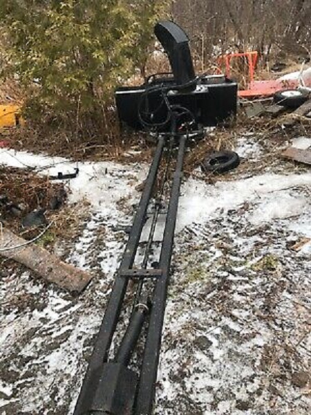

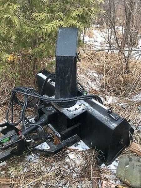

I gave the Zudiburg a look , but their almost as much as I paid for my tractor . I'm going to try to send in a pic of the blower & you can see some of the mounts unfortunatly when the guy took th epic he left it sitting in the weeds. WOW I have to say this forum has teh easiest way to attach a pic of any of teh forums that I'm in . Thanks for that too

As seen above the solution is to always mount a front snow blower on a dedicated frame or mounts that are attached to the main tractor frame very close to the front of the tractor, none of these frames are carried by the FEL. Thanks to Dave for sharing the great solutions that people come up with.
Just trying to be practical hope the OP finds a good solution that works for them. The last photo above looks to be a real solution as it is frame mounted to the front of the tractor (not FEL) and is rear pto driven.

Yea , I watched that guys vid . We need to come up with something pretty soon . The guy with the blower that I posted the pic of doesn't seem to have any info on he blower . We're snowed in , hope to be out by Tuesday & then hope to get over to give the blower a look-see . So Dave_Eng how did that blower in your pics attach to the tractor ?

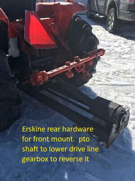

thanks for all the input
animal
Go to the Eskine web site. The blower in my pictures, the one in the weeds, they are all the same Erskine product.
Erskine
The under tractor frame supporting the drive shaft is connected to the underside of the tractor to hold it up but the pushing forces are handled by the drive shaft frame connected to the 3 pt hitch arms.
