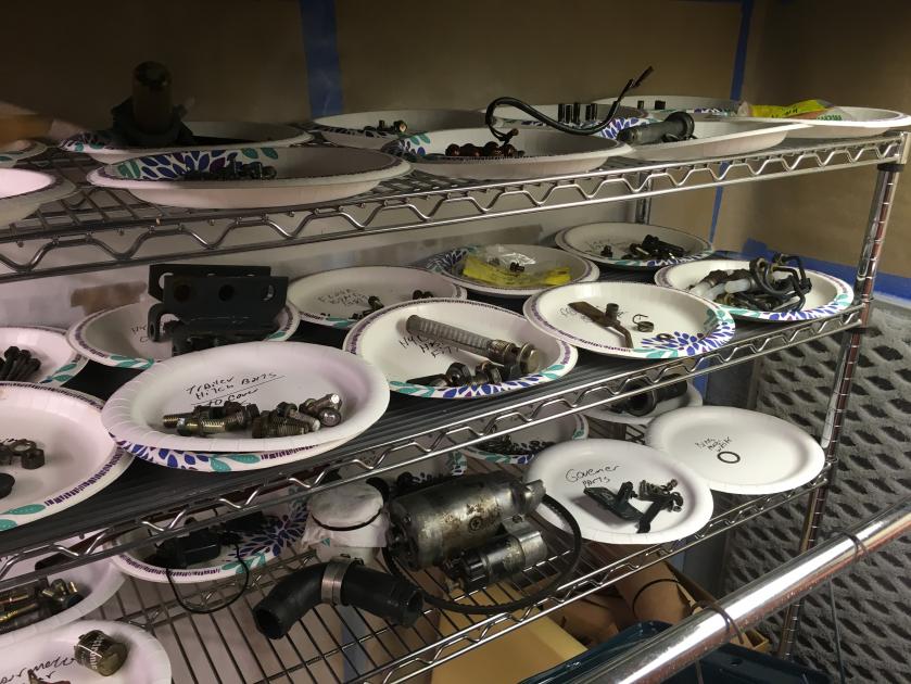

Fish - great photos - like your shop.
It probably sounds foolish, but I like the paper plates with the small parts. Much easier to see than baggies, and I never write well enough to read my bag labels.....

Thanks.I got the idea from a YouTube video of a guy restoring a car. Before I saw the video I had several of those oil drip pan trays with little piles of parts trying to keep them sorted. You do have to be careful not drop the plate or knock it off the bench. Nothing wrong with bags but I like the plates. Maybe cause I havent dropped one yet.

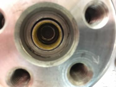

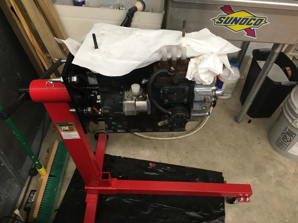

There was delay in getting all my parts do to some confusion at the parts counter. I have been at a stand still waiting on the correct parts. Finally got them late last week. I changed all the oil seals and gasket in the rear and stripped the old paint that was pealing on the aluminum portions. I gave everything a good steam clean and this section is ready for paint. I have some time off so I’m going to work on getting the engine all back together now.

Forgot to mention in my previous post that I decided to go with the PPG paint and epoxy primer and SEM rattle can etch primer for the bare metal portions. I took a piece that I had painted with the Kubota rattle can to have them match. They had a color code already for the blue and both oranges. The blue is in the PPG Delfleet product and the orange is in the PPG Shop line product. I will attach the paint labels for others if they want to go with PPG paint. The label is for the old orange.

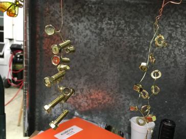

I havent been able to paint the rest of the parts yet do to the cold front we got. In the meen time I started replating the nuts and bolts and othe hardware that doesn’t get paint. Also working on things around the house for the wife. But still moving forward. I plan to get the engine on the bench to mount the flywheel and starter to bench test it before I mount it back to check that it is running good. Hoping to get that done by next weekend.

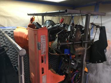

I have tags attached to some things. All the small parts I separated on white paper plates with a discription of what it is and where it goes written in the bottom of the plate with a sharpie and placed on a wire shelf rack. As I took it apart I put things in groups. Like in the motor anything fuel related is on one plate, valve related on another, bolts for the right floorboard on another and so on. All the larger parts I have hanging another rack.
