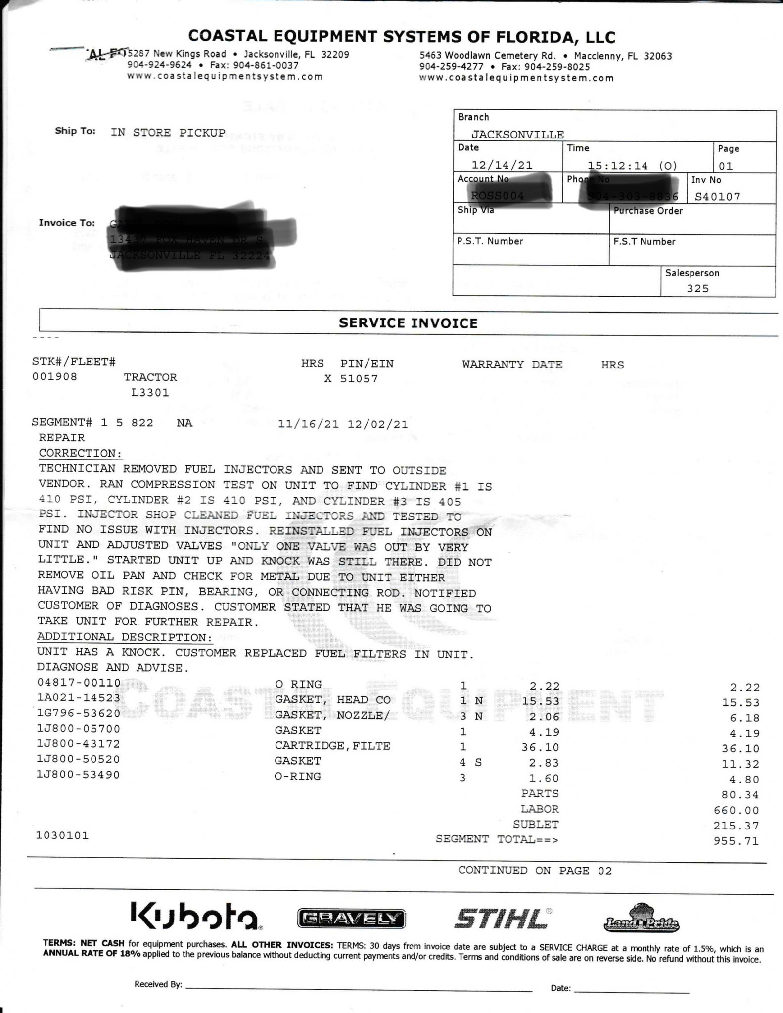

Hello all new here I had a knocking noise on my kubota L3301 (970) total hours
Dealer tested cylinders #1&#2 2(410 psi) #3(405psi) injectors were sent out for inspection all were fine and cleaned
The Kubota dealer in Jax says new motor and kubota won’t let them rebuild etc has to b3 a new $11k kubota motor
I have taken it back to the dealer where I bought it down in Hastings hoping for a better second opinion hopefully today
Im looking for any advice on other options I’m hoping to find a rebuilt engine or get mine repaired somewhere trustworthy
I will be calling MG industrial today for a engine price, I think they could do the swap out hopefully
Any advice I would very much appreciate as. Am down for a few months work due to this expected
Attached is the bill with details

Man I'd be 'upset' with less than 1000hrs and being told 'need new engine'....
Look for a shop that rebuilds forklifts or semis ?
It sounds(no pun) that you may have spun a bearing ? A rather 'simple' repair as long as chrankshaft isn't scored. For the price of an oil pan gasket and an hour labour,you should confirm/deny THAT is where the knock is coming from.

The tech writer was just practicing their Engrish
This is the first time I have heard of a bad "risk" pin.
A few on here and TBN have had problems with "zerts" however.
I feel for the OP on what looks to be a costly problem.

Why would Kubota not "let" them rebuild engine? They have no say in the matter if its not warranty.

I hope it doesn’t have a bad “risk” pin 😱
Was told to do an oil analysis and have the injectors rechecked possibly by the right shop
No idea where he sent them out for two days ?
They are electronic injectors btw

I was told the oil pan is part of the fame not sure how difficult that would be to remove and repair from the bottom but it makes sense to me that it could be repaired instead of motor replacement
I think oil analysis is my next step

I paid my way thru college working on the assembly-line at an aircraft engine rebuilder. While attending flight training I worked as a Toyota dealership tech and made many deep engine repairs.
I have NEVER seen a “spun” main or failed rod bearing that did not require the crankshaft to be removed for re-work or complete replacement.
5,249
3,877
A turning of the crankshaft or even a complete replacement still has to be a lot less than the cost of a new engine. The only reason that I could see that it wouldn't be repairable, was if parts were not available.

Why a new engine...
...probably because Kubota doesn't train their dealer techs on HOW to tear down, rebuild engines. They'd also have to have a 1/4 shop dedicated to it and lots of special 'engine rebuilding tools', and it's not just ONE model of engine.
For Kubota to warranty their work/parts, they insist on a 'crate' engine. $11K for a new motor sounds steep, but they'd include removal from the tractor and installing a 100% complete new engine(NO parts from your engine),plus a couple hours testing ?? Be interesting to see if YOU or they keep the 'dead ' engine(check the invoice !!!). Great scam here is shops keeping YOUR OEM cats,even though they are YOURS.

what if its not spun main or a rod bearing?
im curious now if it still might be an injector? they are electric was informed that only few shops (recommended by Kubota) can do a correct diagnosis mine was done locally in Jax 2 days
just doesn't make sense to me I've babied this machine at my farm with only 970 hours

I think an engine is not rebuilt by the dealer because the government wants old engines destroyed and equipment compliant with EPA regulations. So a new engine is sold/installed and the old one is destroyed with proof to Kubota. So if a new one is available it must be EPA compliant so the 11K cost.
I'm sure Lugbolt or others will comment.
I would be inquiring with the second shop as to WHY they come up with the diagnoses they do. You need to have facts not opinions.

If the engine is out of warranty, Kubota has no say as to whether the engine is repaired, rebuilt, or replaced and would not tell a dealer not to repair one. Your dealer is just trying to sell you a new engine rather than open up the one you have.

Kubota does not dictate how or what to do to repair an out-of-warranty unit as long as it does not create an unsafe condition.
The only time an engine has to be destroyed is when you are replacing a pre-tier 4 engine. You are required by Federal law to drill a hole through the block, into a cylinder near the serial number and submit a clear picture of it. Until Kubota has the picture, they will not send an engine to you.
The L3301 engine is a tier engine, so no issues there. A new engine would come with a new ECM and a new DOC muffler included.
As far as rebuilding an engine, there are no restrictions by Kubota and the repair is warranted by the dealer. There are also independent rebuilders who offer a rebuilt engine exchange or send them your engine and they will rebuild it and return it to you.
