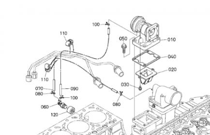

Key 010. My '11 M7040 also has a EGR valve
Thanks TxJim for the pic. This is the same setup my 8540 has.
I'm wondering if there would be any benefit to remove the components, or just plug off the connection on the turbo, and leave all else as is. ???

Gwtx,
You have a M8540HSC-1, the M8540HDC did not have the EGR valve that's why I was asking where you seen it, wasn't disagreeing with you saying it had it, Thanks Tx Jim for the pic to clarify it's location.
I don't see a reason why you couldn't do a delete on it, it's a mechanical Injection pump so no reprogramming required, it's only when you get into the common rail systems that it becomes an issue.
If you wanted to do very clean delete, the M8540HDC intake and exhaust manifolds do not have the EGR provisions, and would bolt right on. ;)

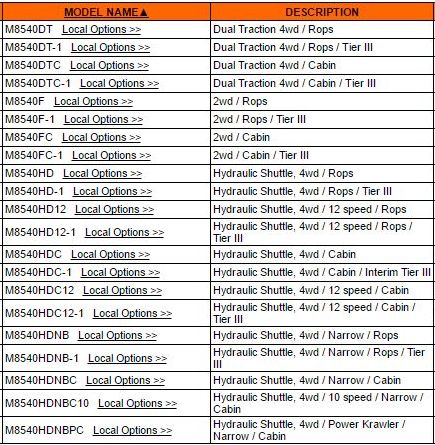

28,723
5,133
@ wolfman:
And I'm NOT disagreeing with you, cause like I said, I'm new to Kubotas, but,,,
I have been looking everywhere for information on a 2012 M8540HSC-1. I can't find anything on TractorData, google, or bing. Is this a limited run or something??.....or maybe M8540hDc-1 ?
The -1 just means that it was a change in some key part of the tractor, like emissions control in this case.
Here are all the different models and variations of the M8540's (the M8540 only has -1 right now, might change to others later), and no most sources of info will not go into -1 -2 -3 differences.
