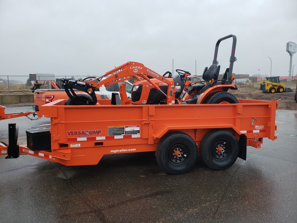

I have a 14' Midsota that works great! It is beg enough to haul my B2601 with loader and a couple other attachments, has for pockets in the front sides so I can leave my pallet forks on it to load and unload attachments or other bulk items. Once at a site I can load and haul anything I need to. Wasn't cheap at about $11k but worth every penny!

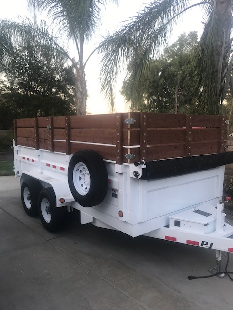

I did a lot of research a couple of months ago and purchased a 14' tandem axle PJ Trailers dump trailer. 2' sides because it was less expensive and arguably more versatile than 4' sides. I subsequently constructed some 2' wood stake sides for <$200.
Many dump trailers use a hydraulic ram as the sole "lifting" mechanism. I was concerned about the lateral stability of these types of dumps. The PJ model I chose uses a scissor mechanism adding a LOT more stability. I'm thankful for this added lateral strength after having used the trailer now several times with heavy loads. To wit, in order to dump a full load, the trailer is raised to its full 45-degree angle. The load shifts and slides partially out. You then need to pull forward to let the rest of the load slip out. My trailer has been absolutely perfect in these scenarios.
Anyway, I spent much more than most people on a dump but part of my logic is that I will need it for ~24-month timeframe while I clear a building site and do a home/shop construction and then I will re-sell it. As the op has observed, they hold their value really well.
