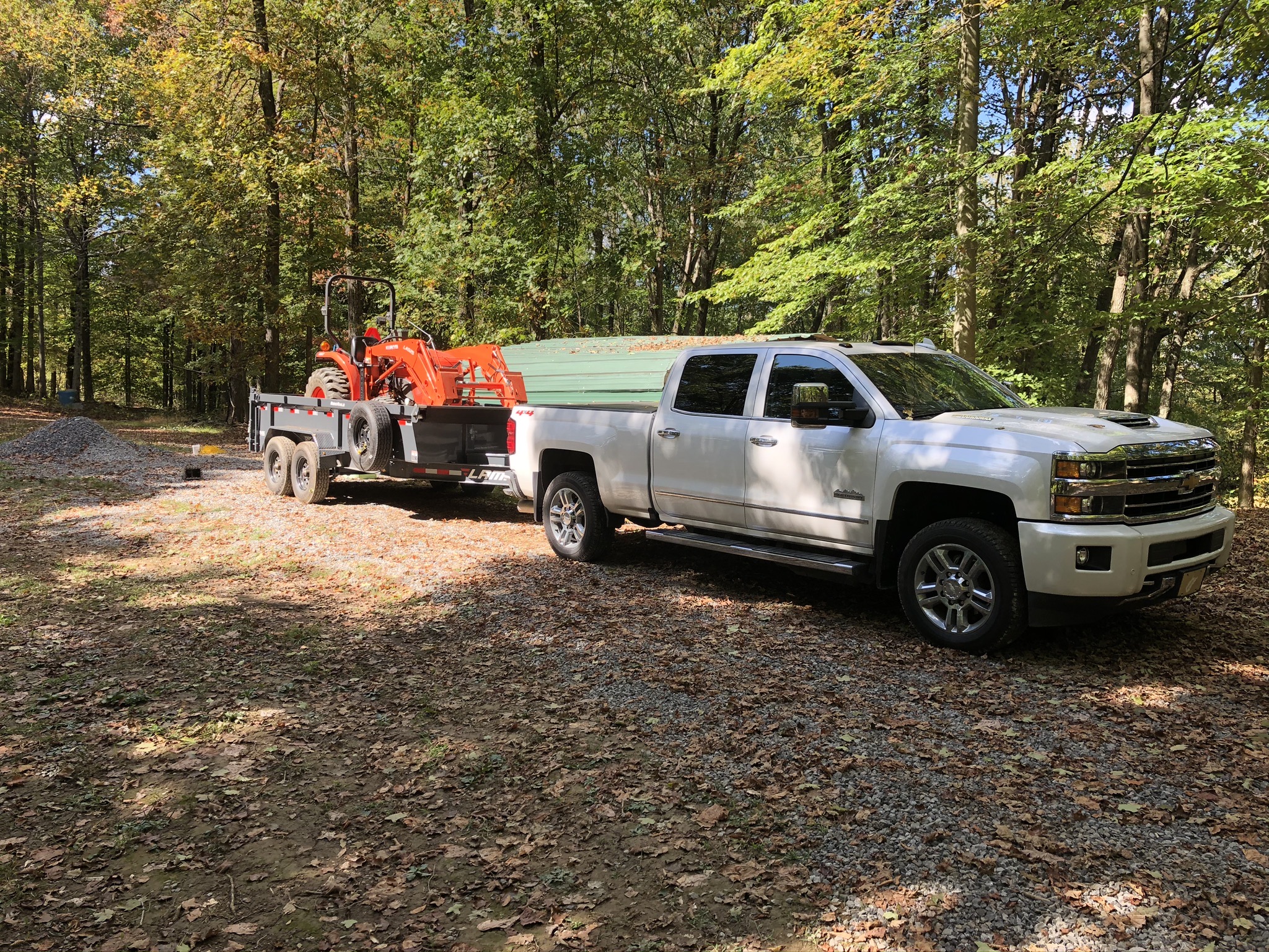

the ones I’ll pull with my tractor are the small 6x10 10k dump (only empty) and occasionally the 20’ aluminum gravity-tilt, (just to reposition it) from time to time.
