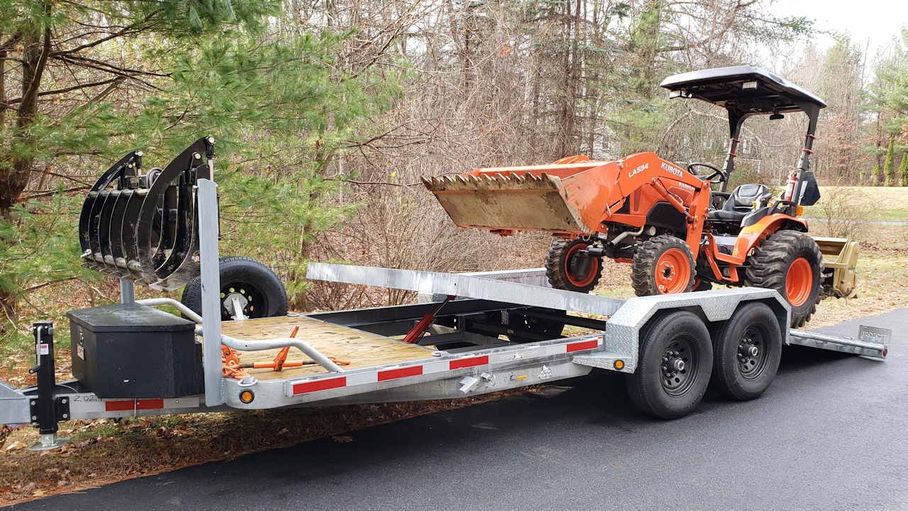

This is kinda timely as I was looking the other day at a 22' 15K GVWR tilt bed for possible Spring purchase.
The dovetail with ramps were fine but once I added some of the features I wanted the tilt bed was only maybe $500-800 more......
I was thinking the 14.5' tilt portion was more than enough for my B2601 and the 8' front fixed portion is great for additional implements.

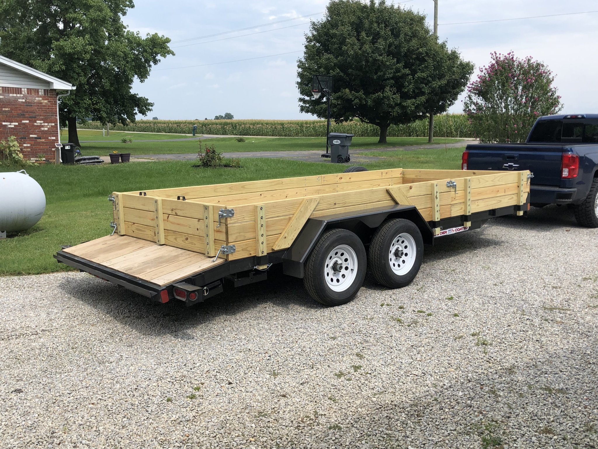

Had the PJ dovetail 18’+2 and loved it, mainly for sidexside’s & four wheelers at that time. Pulled great with 1500 extended cab silverado lb.
