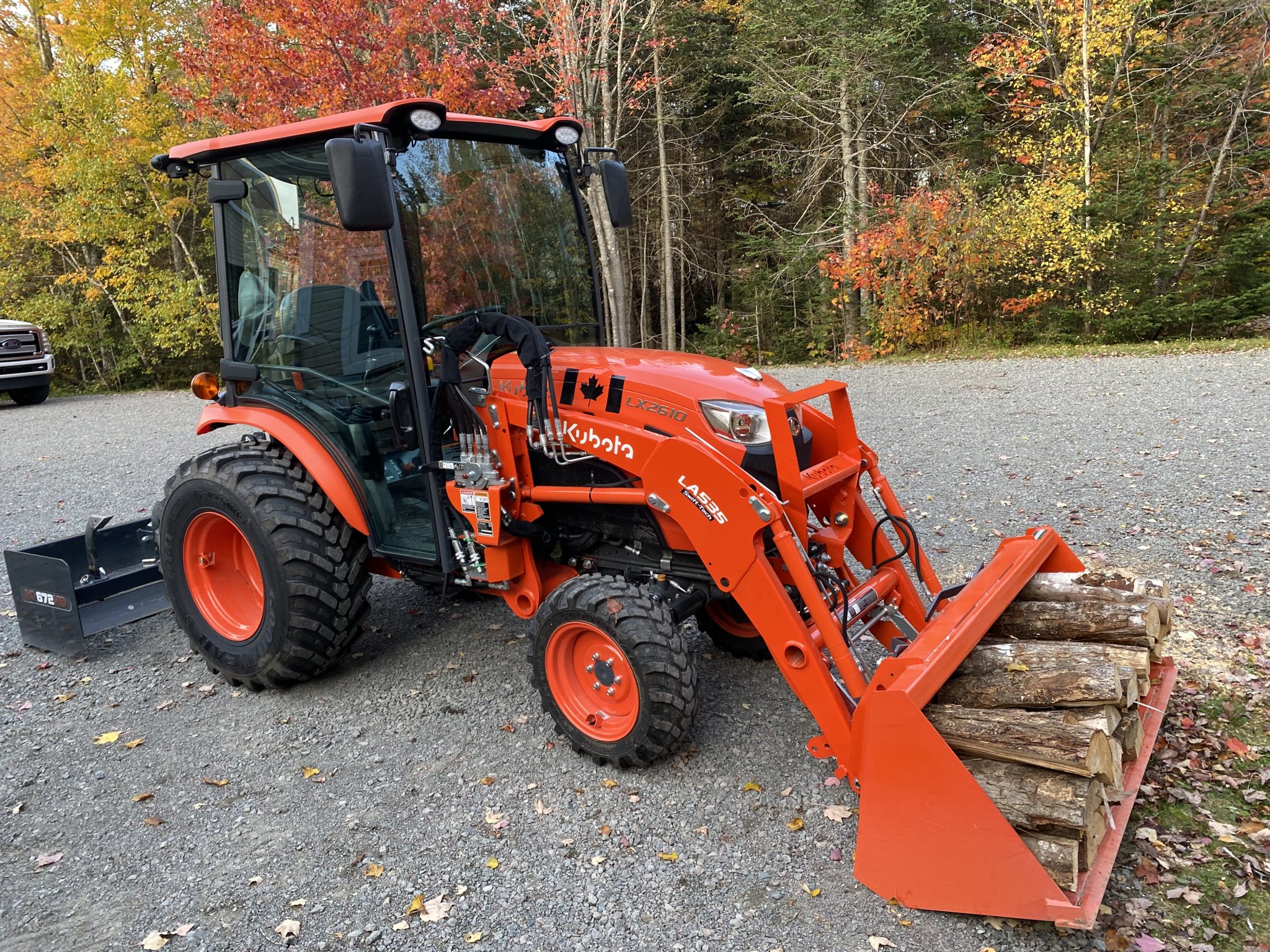

Hello all, new to this forum and new to Kubota tractors in general. I recently purchased a 2022 LX2610 July just passed and just realized I was given the older style B2356 loader bucket with my brand new machine. Realizing this only because I wanted/needed a bracket with hooks and trailer sleeve for obvious reasons. When ordering I noticed this was the case. Can anyone tell me if there are any real differences or benefits to the Newer buckets? I did search here and google but couldnt come up with anything solid.

Interesting. I wonder if these would be similar in those aspects. My 2610 has the new LA535 loader with 3rd function but the older bucket. No predrilled holes, but the angles of the buckets look different somehow? Maybe one is more square back(older) and one more round? Im basing this strictly from pictures online.

Im not sure why but it looks a lot bigger to me. Im wondering if the volume of it would be bigger? Mine is also a 60” Light duty.

They are not the exact same. One has a curve on the front side walls and one doesn't. Also, the square tube top rail on the OP's bucket looks noticeably more substantial than the top rail on SGR's bucket.. and since that's what you'd probably be attaching hooks/receiver to, all the better!
I would say if you do not have any specific problem with the bucket on your machine, just plan to keep it and modify it to suit as needs arise.
