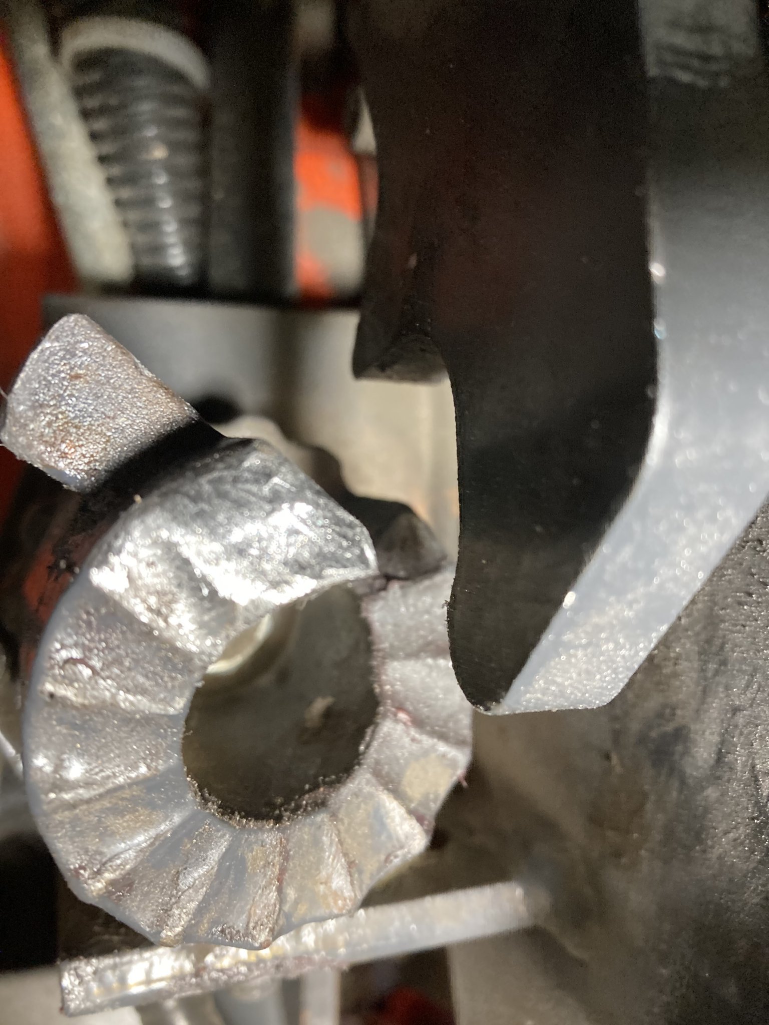

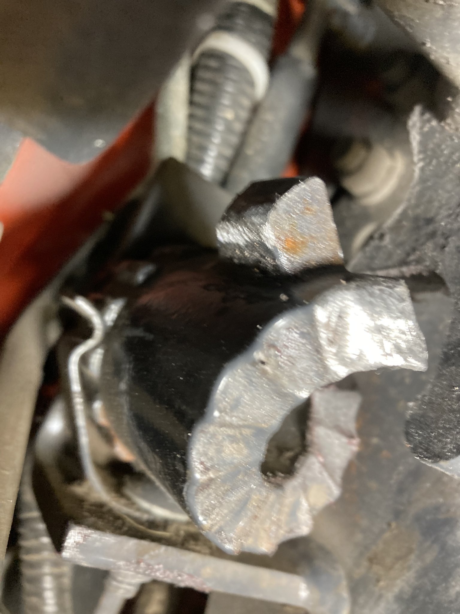

Ugggh. Trick in above post did not work. Another site, someone recommended adjusting the linkage set bolt( left side, behind wheel) - no dice with that. Took deck off and had a look see. The bottom of that spiral cam has a nub sticking out on 1 side, it looks like it’s supposed to go into that notch that is on the linkage. I ended up grinding the bottom of that spiral flat, and ground some of that nub off with my Dremel I was able to get the knob into the “top” position with deck off. Once I got deck on it wasn’t as nice. I need to grind sone more off that nub, I need to get another stone for the dremel though. I believe I’m on the right path, don’t know why it would work before then not be able to… these pics are after I ground it down....

DO NOT DREMEL THAT ADJUSTMENT WHEEL !!!!! You have a bent front deck hanger!
One day in a rush I put the mower deck on and didn't lock one of the pins all the way to the lift bar. When I went to lift the deck it let loose and one side fell while the other stayed up. Since then when I turned the deck height adjustment knob it would turn all the way, but stopped one setting before TOP.
This was my fix!
If you remove the front bracket that holds the the front of the deck to the front of the tractor and take a good look its likely tweaked, bent. Mine wasn't bent too bad. I took the end with the nut on it and put it in between a space on a railroad tie wall and gave it a few good pulls (NO VICE) :confused: checking as i went. Walla! That adjustment knob never turned so smoothly!

Straightened front hanger bracket, still no change. Out came the Dremel again:ROFLMAO::ROFLMAO::ROFLMAO:….
